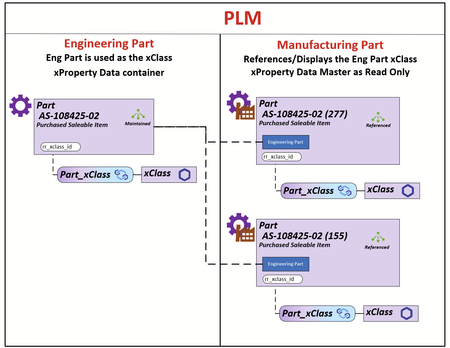

Reference an Engineering Parts xClass xProperty as Engineering Master Data
My client uses the Part Itemtype in 2 contexts Engineering and Manufacturing. The requirement is that all xClass-xProperty data is populated and maintained on the Engineering Part and the xClass-xProperty data on the Manufacturing Part is rendered using the Engineering Parts Id. The Engineering Part that will be used for the reference will be the Latest Released Generation. The illustration demonstrates the relationship between the Engineer Part and its Manufacturing Parts. What I do know is that all the xProperty Data is store in the table set [xp.XpropertyValues#] as shown below. All xProperties can be acquired using the ID of the Engineering Part (I have a SQL query that can do this for reporting for a BOM structure). I have modeled the js/ts methods but I can't figure out how to apply them in this use case. What I can't figure out is: 1) What are the options for rendering the xClass-xProperty container on the Part Manufacturing Form 2) How to populate that container using the ID from the latest Released Engineering Part Any help/ideas would be greatly appreciated. Thanks Scott38Views0likes0CommentsxClassification Insufficient permissions

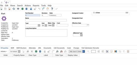

I have created xClasssifications with set of xProperties and linked them to Part ItemType. When I tried to added xClassifications it give's an error as below " You have insufficient permissions to perform 'classify' operation for item id '29F57869D3E348FA92AB855F6A029EFE' by xClass id 'F1D35D96534B47BAB447134E6C309CC5'. "80Views0likes1CommentHow to use explicit xProperties in ItemType?

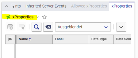

Hi community, is any familiar with using explicit xProperties in ItemTypes? Inside of a ItemType there is a relationships "xProperties". When can add custom xProperties there. These new properties will be automatically linked in the grid so user can enable/disable them by themselves. This is works very well and would be exactly the behavior I am looking for my current use case. But I struggle to "use" these direct xProperties. I cannot add the fields to a Form. I right now have no idea how users can add values to these new properties. Does any knows how to use these properties? Best regards and thanks for any hint! Angela207Views0likes3CommentsDisplaying In-Line Units for xClass xProperties
