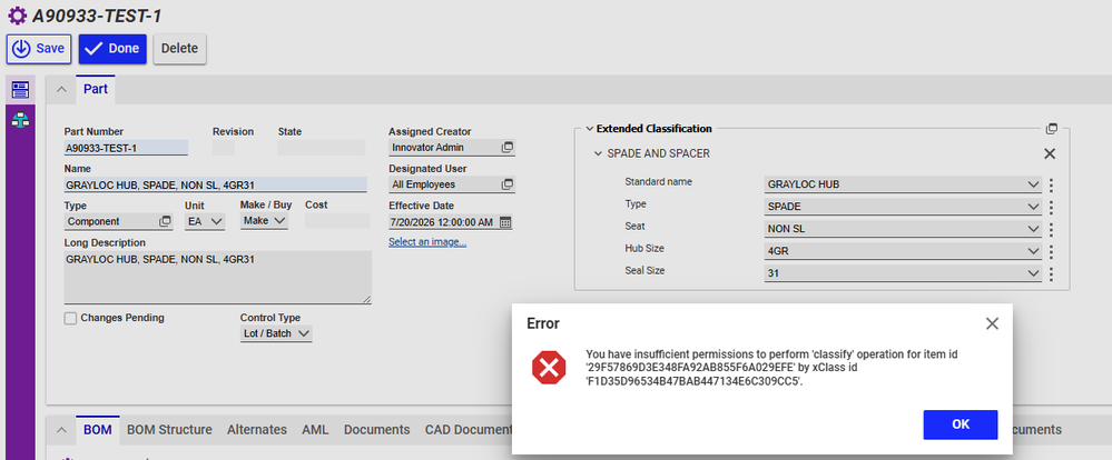

I have created xClasssifications with set of xProperties and linked them to Part ItemType.
When I tried to added xClassifications it give's an error as below
You have insufficient permissions to perform 'classify' operation for item id '29F57869D3E348FA92AB855F6A029EFE' by xClass id 'F1D35D96534B47BAB447134E6C309CC5'.
  • Hi , This error usually inidicates missing classification permissions. Could you please check the following?
    • Open the Item classification permission applied to part under your created xclassification Tree.
    • Under the Access tab, check the Identities grid (any group user belongs to).
    • Ensure that the Can Classifiy checkbox is checked for an Identity that your logged-in user is a member of.
