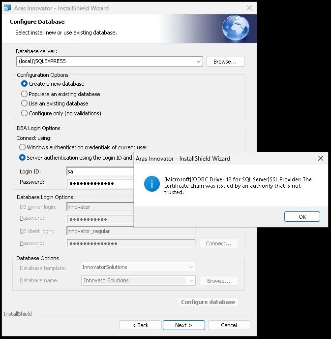

Installation issue : ODBC Driver 18 SSL Provider error
Hello 😊
I'm trying to install Aras Innovation (all in one server for testing purpose)
and I'm stuck on this nice message while trying to connect to the DB :
Just to inform that my system is under :
  • Windows Server 2025 Datacenter Azure Edition (10.0)
  • IIS server version 10 (10.0.26100.32860)
  • .NET 6.0.36 installed
  • Microsoft SQL Server Express 2025 (17.0.1000)

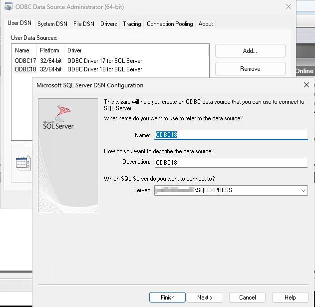

☝️ And I've already pushed ODBC17/18 but without success regarding the install.

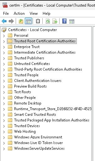

  • It is problem with SQL Service user. You need to give permission to sql user in the 'Manage user certificate'.
  • Hi Germain,
    1. Run -> certlm.msc
    2. Choose Server certificate -> Right click -> All Tasks -> Manage Private Keys
    3. Give permission to SQL Service user
    4. Restart SQL service
    And try connecting to database
    • Germain's avatar
      Germain
      Hello Kalaiselvan,
      I'm sorry but can't see the "Server certificate" to right click on...

  • Is "Force Encryption" Yes or No in your environment?
    Is there anything in the second tab (Certificates)?
