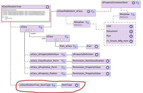

      To support the discussion I have added 2 snaps below. (I think they are pretty close)
      Data Model:
      Javascript Model:
      I hope this helps to support the conversation.

      • srmorrisonearthlink-net's avatar
        Here is a corrected data model.
        Also. I proved out, manually, that the order of the presentation of the xClass is managed by the classification_hierarchy property values.
