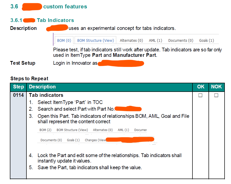

    So far I used MS Word, the individual steps looked something like this:
    My document contains general tests and specific tests for PE, MPP, code tree mods, custom stuff, etc.
    Word is not my favorite format for a test plan. I haven’t done an upgrade in a while.. I wrote these test cases long before a test plan was even a requirement at all. Today I would also include the names of relevant Methods, better (more detailed) description, better English, better images,...

      I believe nobody really wants to see their own test plan made public. And I don´t think Aras wants that either. I deliberately chose the “Tab Indicator” example above because I´ve already mentioned this feature about a dozen times in the forum anyway.

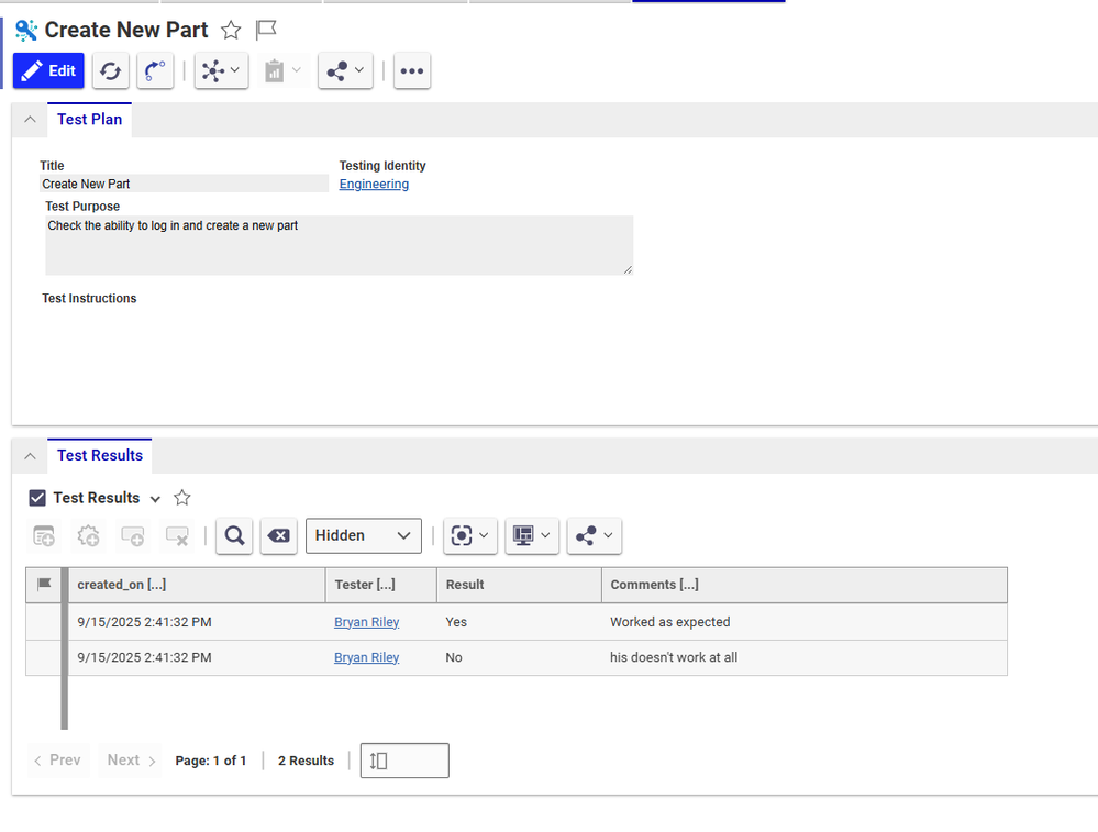

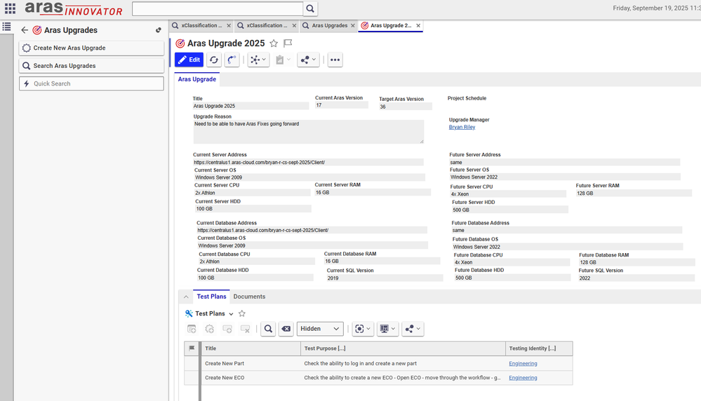

        So I gave it a rough prototyping, using three different ItemTypes (Aras Upgrades, Test Plans, Test Results)
        Upgrade ItemType has current / future version, link to Aras Project Schedule (could set up a project template), information about current / future server locations and hardware (thought about separating that off) and relationships with Test Plans and Documents
        Test Plan Page is linked to an Identity and PDF (or Technical Document) Instructions and has a relationship with 'Test Results, which is just the user, date/time, pass/fail, and comments.
        You would basically send the link to the Test Plan to the identities related, they open the instructions and log their results
        Unfortunately I built this in a temporary environment so it will be destroyed. But I have exported it so it could be recreated.
