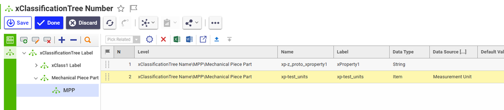

Migrating from another system, they have a lot of properties that also include units. Like this:
How can I modify the Extended Classification display to show units in line like this?

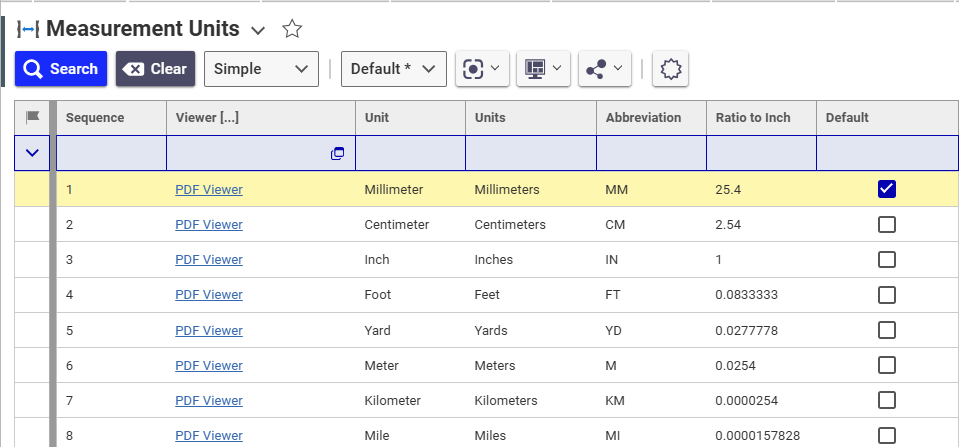

My plan so far is to build out ItemTypes for each type of measurement (Length, Temperature, etc) similar to the default 'Measurement Units', including a conversion value to whatever base unit is decided. (Anyone know why there is a 'viewer' on this itemtype?)
So then I could build xProperties linked to the ItemType for that type of unit, and add it to the xClass which would put the UoM as another line in the xProperties
So the question is how would I modify the xClass Display so that I could pair up the two properties and get an in-line display of the units? (and do it for some properties, not others, and for many properties within an xClass)
  • From my POV the "Viewer" property is to link the measurement units to applications like SSVC.
