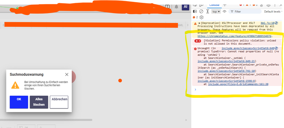

Edge upgrade kills search grid - find workaround here
Hi communty,
if today your Edge users report that "Innovator doesn´t work" - this is the post you need.
Does you Innovator look like this?
Solution #1: Use Chrome
OR
Solution #2 (temporary workaround until we find a better fix):

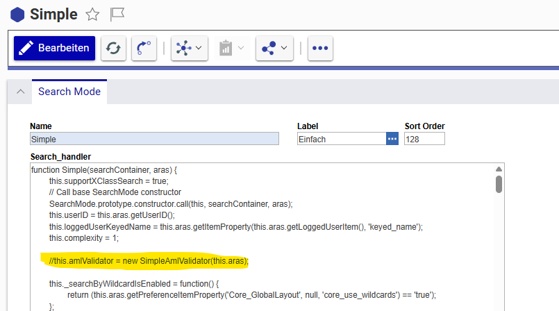

Add SearchMode ItemType to TOC. Edit Simple Search mode. Uncomment yellow highlighted line:
Affected Edge Version: 154.0.4258.37

      I was already wondering how long it would take for the first reply to this post. I think there will be many more to come.
      I currently work on a better solution. The workaround will have some minor impact to Saved Searches / Favorites. The patch eliminates the automatic switch to SearchMode AML or Advanced.
      1. Login as Admin
      2. Navigate to TOC -> Administration -> ItemType
      3. Search for ItemType SearchMode
      4. Go to TOC Access tab
      5. Add Identity Administrators. You can choose a Category, but you don´t have to
      6. Save the ItemType, SearchMode will be available in the TOC
      Then
      1. Navigate to TOC -> Administration -> Permissions
      2. Search for Permission SearchMode
      3. Add Administrators and give them get and update rights.
      4. Save permission
      Then
      1. Navigate to SearchMode in TOC
      2. Open Simple SearchMode
