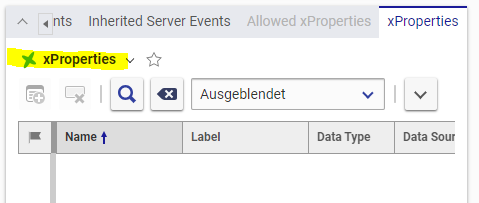

Inside of a ItemType there is a relationships "xProperties". When can add custom xProperties there. These new properties will be automatically linked in the grid so user can enable/disable them by themselves. This is works very well and would be exactly the behavior I am looking for my current use case.
But I struggle to "use" these direct xProperties. I cannot add the fields to a Form. I right now have no idea how users can add values to these new properties.
Does any knows how to use these properties?

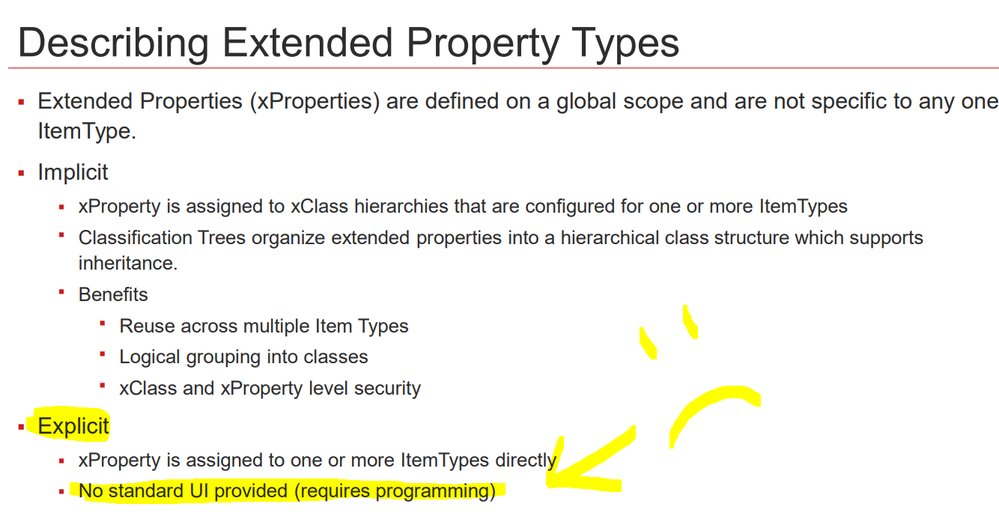

  • I discovered following hint in the manuals:
    Seems like explicit xProperties are a dead-end feature. There is not UI yet.
    In my case I would be happy to display the xProperties in a custom tab (preferred) or inside the main form if there is not other variant.
    I don´t need to edit the data in the Form or Relationships, because the would xProperties be filled by REST API automatically.
    As far as I see even the newer releases don´t support explicit xProperties yet. (and I am 99% sure Aras will forget them in the new UI editor they are working on).
    Has anyone seen a sample implementation for the missing UI?
