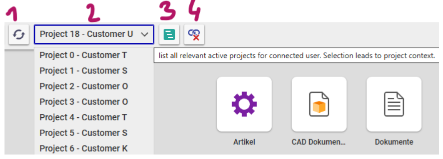

In the following screenshot you will see our implementation so far:
1: should refresh the list (2)
2: dropdown list with all relevant customer projects
3: opens the current selected project in a new tab
4: detach the user from the project and should refresh the list (2)

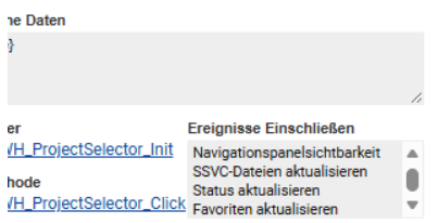

2.1 Include Events
We could identify that the Command Bar Section Item of the dropdown item has a configuration field which is called IncludeEvents. When you select an event named Update State than the dropdown list gets initiallized too often:
Perform a search on an random ItemType -> 4 x dropdown init gets started
Perform a refresh an an random ItemType form -> 2x dropdown init gets started
Switch tabs -> 2x dropdown init gets started
Commit a change on a random ItemType -> 2x dropdown init gets started
Because of performance issues we can not use IncludeEvents.

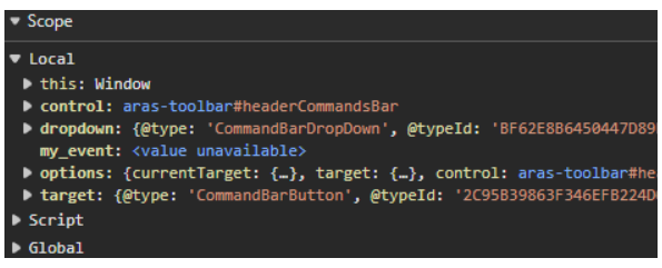

When I am debugging this method I see that in my local scope the object this: Window exist.
this.mainLayout.init seems to initialize the whole window but I only want to initialize my dropdown button.

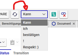

  • I made a short tests...this one worked!!!
    • Hi Angela,
      this is fully functional. For me it is totally fine that you have to add content manually. It produces dublicate code, but it works :)
      Thank you very much and respect!

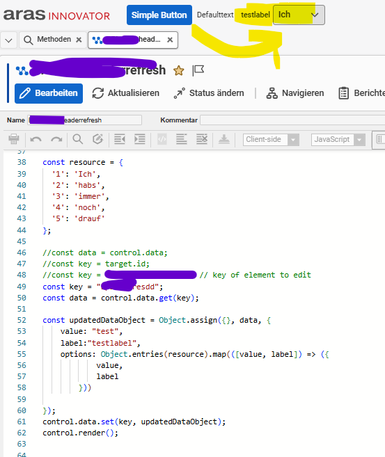

  • Ah ok, I think we need a bit more to make this work. I did a quick test. I added two buttons to the mwh header. One acts as regular button, the other one renders the content as text.
    I added following click Method to the button:
    const key = "ai_mytestlabel"; // Name of second CUI element
    const data = control.data.get(key);
    const updatedDataObject = Object.assign({}, data, {
       value: "testvalue",
       label:"testlabel"
    control.data.set(key, updatedDataObject);
    control.render();
    When I click the button, the label is updated -->
    I think this concept could also work for a dropdown update, but I haven´t tried yet....

      I could also verify that if I run this command,
      this.mainLayout.init();
      (...) in my OnClick methods, than the dropdown button gets also refreshed. But I do not like that behaviour, because the whole window gets refreshed and other strange things happens.
