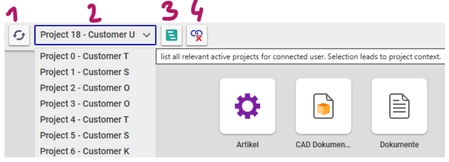

"com.aras.innovator.cui_default.mwh_header" is the top header it self. As far as I remember the header is only rendered once at startup. When I remember things right there are also some "aria restrictions" that prevent any further re-rendering, but I am currently not sure in which context I saw this.

Where does the content for the Project list come from? Is this is classic "list" or ItemType data?

The content from the project list comes from an AML query <Item type = 'Project' action ='get' ...>
angela wrote:"com.aras.innovator.cui_default.mwh_header" is the top header it self. As far as I remember the header is only rendered once at startup.
When working with IncludeEvents, it is possible to trigger a rerender of the Command Bar Section Items every time an event from IncludeEvents is fired. Therefore, there must be a solution to force this behavior.
I could also verify that if I run this command,
this.mainLayout.init();(...) in my OnClick methods, than the dropdown button gets also refreshed. But I do not like that behaviour, because the whole window gets refreshed and other strange things happens.

Can you test following:
control.render();
- reinke_patrick_smc_com6 months agoIdeator II
Unfortunately this does not work.
