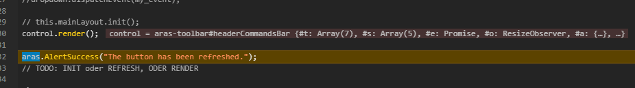

When working with IncludeEvents, it is possible to trigger a rerender of the Command Bar Section Items every time an event from IncludeEvents is fired. Therefore, there must be a solution to force this behavior.
I could also verify that if I run this command,this.mainLayout.init();(...) in my OnClick methods, than the dropdown button gets also refreshed. But I do not like that behaviour, because the whole window gets refreshed and other strange things happens.
- angela6 months agoCatalyst II
Can you test following:
control.render();
- reinke_patrick_smc_com6 months agoIdeator II
Unfortunately this does not work.
