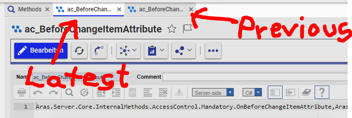

We now have both versions in parallel in the tab pane. This is our basic setup. So far everything is fine.

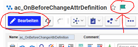

1. Start from setup above. We are in the tab with the latest revision
2. Click "Edit" (but do nothing else)!
3. Now just switch back to the tab with the previous revision of the Method and simply close this window
4. After closing the previous revision, we will automatically jump back to our latest revision tab
5. Click "Discard" as we never wanted to edit anything

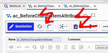

6. Now the error should happen:

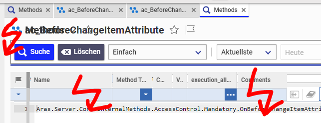

In case of error a second tab reappears. We now have the two tabs for the item. They do not work and you cannot close them. Tab pane is crashed. Everything will be fine again after restarting Innovator in browser.
If you don´t see this error, your Innovator version is not affected by this bug. You can skip all other tests. Please share which version you used!
Reproduce Error 2 (glitch)
6. When you directly click "Search Method" in the TOC after above error occurred, a small additional glitch can appear
7. As our tab pane is crashed, the search grid will overlab with the Method Form. None of the tabs can be used reliable anymore

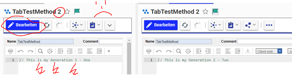

Reproduce Error 3 (previous revision overwrites latest)
Warning: Perform only in test database! Use a custom temporary Method for testing out this one, cause it can corrupt your data!!!

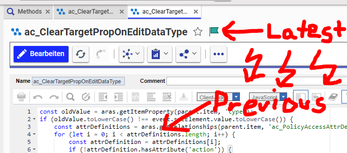

1. Start from setup above. We are in the tab with the latest revision.

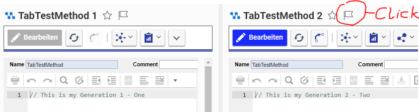

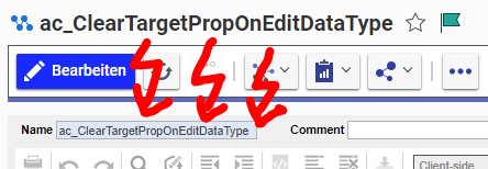

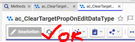

2. First switch back to the tab with the previous revision. This time do not close the window, but simply take a look at the "Edit" button. It´s grayed out and you cannot use it. (This is correct behavior, as we never should be able to edit previous revisions)
3. Switch back to the latest revision and click "Edit"
4. Again switch back to the previous revision and take a look at the "Edit" button again. This time it´s not greyed out anymore!!!
5. It´s now theoretically possible to click the edit button inside the Form of the previous revision!
6. In case you click the 'Edit' button, you can create a high risk scenario:
7. After clicking the 'Edit' button, it´s seems to be possible to edit the previous revision. But what you see doesn´t represent the "truth" any more.
a) The shown Method code still shows the content of the previous revision
b) But the context item has switched to the latest revision. But this revision change is not visible to users as they still watch the previous code/properties. You can only see it in the 'Generation' value in the 'Properties' dialog.
If you now save your "fake" previous item, the latest item will be overwritten with code and properties of the previous version. This is a high danger situation not only for Methods, but for all ItemTypes that use revision as it will lead to data loss and corrupted data.
