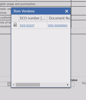

Hello, I've created an item type that is versionable. When viewing the revisions list on the item, however, the pop-up box that appears is very small and you need to scroll horizontally to view all the fields. Is there a way to make it bigger? Version 11 SP9 Thanks!55Views0likes3CommentsBrowse the versions of an item
