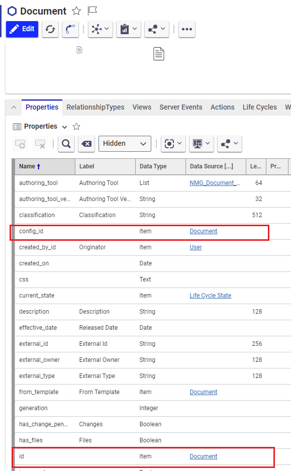

In the system the "Id", and "config-id" are the item name. For Document item, the id is the document name(screenshot below).  I need the id property, the one that is unique, to be added to the properties of Document item.

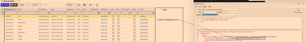

      Hi AJ, thanks for replying. The issue is that there is no property of the Document item that has a "ID" . The id are just the Document item_number(screenshot below). I want the unique IDs, the value in <id> tag, to be displayed in the search grid. I don't want to change the current Data Source of the ID property. I want to add a new property, say GUID, that will show the unique id in the search grid.
