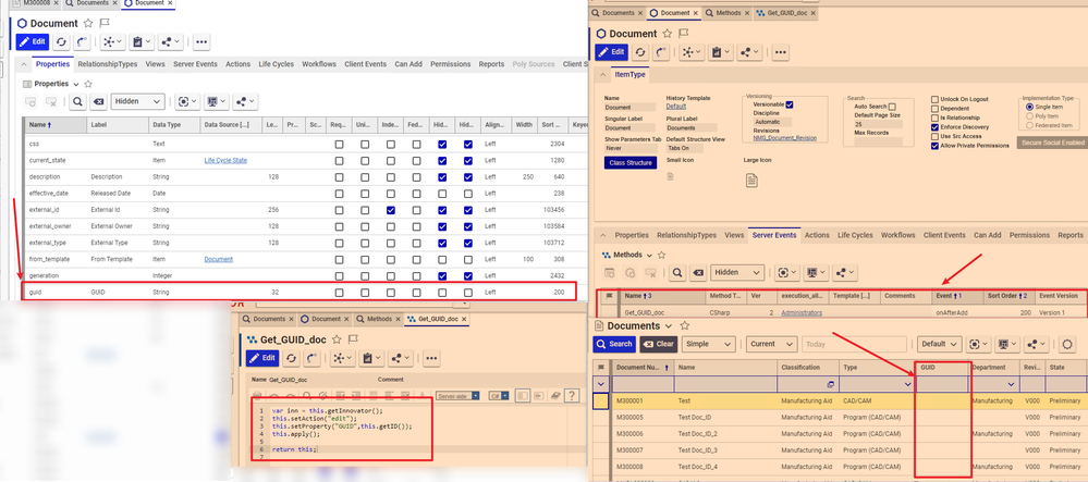

Hi AJ, thanks for replying. The issue is that there is no property of the Document item that has a "ID" . The id are just the Document item_number(screenshot below). I want the unique IDs, the value in <id> tag, to be displayed in the search grid. I don't want to change the current Data Source of the ID property. I want to add a new property, say GUID, that will show the unique id in the search grid.

Thanks for the prompt reply AJ Sebastian Unfortunately, things don't work on my end.
I added the method but I don't get the ID in the GUID column in the search grid, screenshot below. Am I missing something?- asebastian2 years agoCommunity Manager
It might be a case sensitivity issue in that instance. Your properties name is guid, and the label is GUID. In your method try changing it to lowercase and see if that helps?
