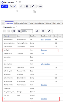

In the system the "Id", and "config-id" are the item name. For Document item, the id is the document name(screenshot below). I need the id property, the one that is unique, to be added to the properties of Document item. I have this method but it doesn't work: Item myItem = this.newItem("Document"); myItem.setID(this.getID()); Item results = myItem.apply(); Error is "Error Number: CS0161, 'ItemMethod.methodCode()': not all code paths return a value" Also, once I have this method working what are the next steps. I guess I will have to add this method to the Server Events, event onBeforeGet, correct? Any help is appriciated. Thanks!264Views0likes5Commentsapply PE_createNewRevision from client method
