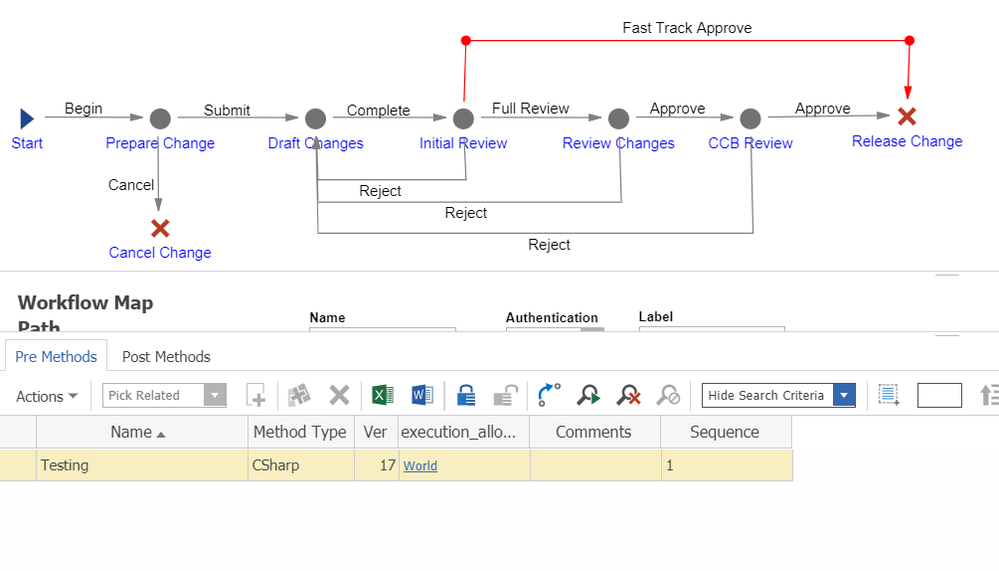

In my work flow I have a stage with several path's, one of them is called "Fast Track Approve"
How can I set so that path only is valid for the CM /Admin identity?
It would have been nice if Aras had possibilities to set permissions/Identities on path,
But it looks like this must be solved by a method.
So I need a method to check user vs identities and then have the method to be run as a pre-method for that path
Regards//Mikael

    • mkalla's avatar
      mkalla
      Sorry, but didn't work for me
      In the Stage for Fast Track Approve I have two identity groups assigned
      "Group1" with User A and User B
      "Group2" with UserC
      UserA, just a standard user, not CM or Admin,
      UserA claims the stage and when UserA selects  "Fast Track approve",
      It works for him and ECO is forwarded
      It should have according to the method being stopped
      Any idea why UserA was able to forward though fast track approve?
