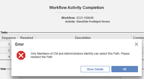

I tested your scenario and able to block user from vote. Can you check below case
1. Is this user member of CM / Administrator identity ?
2. Is this user member of any identity which is member of CM / Administrator identity ?
Example : user is member Group A and Group A is member of Administrator
3. Is the ID configured for CM and Administrator identity correct ?
4. If so, then can you debug this method and check ?
if (System.Diagnostics.Debugger.Launch()) System.Diagnostics.Debugger.Break();
Innovator inn = getInnovator();
//Allowed Identities (CM and Adminstrators Identity ID)
string allowedIdentity = "F6624E9AE5504958A84E4B6A5831298B,2618D6F5A90949BAA7E920D1B04C7EE1";
string userID = inn.getUserID();
Item alias = inn.newItem("Alias", "get");
alias.setProperty("source_id", userID);
alias.setAttribute("select", "related_id(id)");
alias = alias.apply();
if (alias.isError()) {
return alias;
string aliasId = alias.getProperty("related_id");
string whereCondition = "[Member].related_id=\'" + aliasId + "\'";
Item IdentityCheck = inn.newItem("Member", "get");
IdentityCheck.setAttribute("where", whereCondition);
IdentityCheck.setAttribute("select", "id");
IdentityCheck.setProperty("source_id", allowedIdentity);
IdentityCheck.setPropertyCondition("source_id", "in");
IdentityCheck = IdentityCheck.apply();
if (IdentityCheck.isError()) {
return inn.newError("Only Members of CM and Administrators Identity can select this Path. Please reselect the Path");
return this;

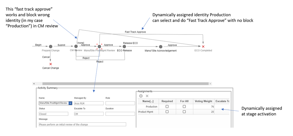

Hi Gopikrishnan,
Still not working for the specific stage, in my case this stage is dynamically assigned, so on create ECO user selects from a drop down list the Groups (identities) to be assigned, then a method checks that and set these identities as assigned (this assign method works really good).
However, if I on another stage add a "fast track approve", have assignee's directly in that stage (no method to add them), then your code blocks the user to go that path if not correct identity
So your code works, it is somehow related to the dynamically assigned identities.
My workflow and Dynamically assigned Stage when it has become activated looks like this
//Mikael
- mkalla6 years agoCreator I
Hi again,
There must be some issue related to the voting weights
In my previous test where I had direct assigned identities with 100% voting weight each,
your method worked as desiredBut when I changed it to have 75 for one assignee (not CM or admin related) and 25 for the other, then the user with 75 could do the fast track approve without blocking him for doing that
To test voting weight theory, I now tested to update my automatic assign method so the no-admin identity group got 100% in voting weight instead of 75
Then your method works perfectly
So it is related to voting weight
//Mikael
