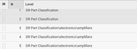

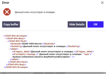

Hello Everyone, I am currently struggling with xClassification and I need some help/insight. My current client created an xClassification structure, xClass and xProperties, sometime ago from and Engineering context. As a corporate goal they are now challenged to create an Enterprise xClass and xProperties structure that will be used to publish, from PLM, to a Convergence system, Oracle EBS, and Oracle Fusion using an Enterprise classification structure. So My current challenge is to updated the current xClass-xProperty structure to the the hierarchy while preserving all the current/existing xProperty data. Thus far I have been able to: 1) Rename all xClass items required 2) Generate the [From_RefId - To_Refid] string that establishes the xClass Hierarchy xClassificationTree.classification_hierarchy 3) Align xClass_xPropertyDefinition with xClass_xProperty_Flatten with xClass.xproperties_sort_order The ClassificationTree loads as shown below But when I try to save the xClassification tree I get this error: I found the Error String in {Aras.Server.Core.dll}. internal class XTreeMigrationModel but, I'm not sure what it is actually doing to throw the exception. Below is the code snippet that throws the exception.62Views0likes1CommentReference an Engineering Parts xClass xProperty as Engineering Master Data

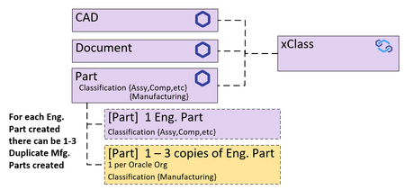

My client uses the Part Itemtype in 2 contexts Engineering and Manufacturing. The requirement is that all xClass-xProperty data is populated and maintained on the Engineering Part and the xClass-xProperty data on the Manufacturing Part is rendered using the Engineering Parts Id. The Engineering Part that will be used for the reference will be the Latest Released Generation. The illustration demonstrates the relationship between the Engineer Part and its Manufacturing Parts. What I do know is that all the xProperty Data is store in the table set [xp.XpropertyValues#] as shown below. All xProperties can be acquired using the ID of the Engineering Part (I have a SQL query that can do this for reporting for a BOM structure). I have modeled the js/ts methods but I can't figure out how to apply them in this use case. What I can't figure out is: 1) What are the options for rendering the xClass-xProperty container on the Part Manufacturing Form 2) How to populate that container using the ID from the latest Released Engineering Part Any help/ideas would be greatly appreciated. Thanks Scott52Views0likes0CommentsxClassification Insufficient permissions

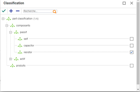

hello i'm begining a project, the idea is to have a an action launch a dialog to select a xclass. I would like to launch the same dialog as the one that pops up when adding a part xclass and x property(see below): after the user selected a class i want to retrieve the name of the class he chose. The following step is to have a second dialog (depending on the classification chosen) this second dialogs might be hard coded or dynamically buit i'm still unsure and they are going to look like the form used to fill the xproperty after you choose your part class but slightly different: i want to add a column of check boxes for future business logic. i've tried to search for the xclass tree selection dialog but couldn't find it i've tried to display some that i could find in the code tree but without sucess, i used the dialog api, here is my code: var param = { aras: top.aras, type: "HTMLEditorDialog", sHtml:"here i've tried to put just the name and the full path but it didn't seem to work as even when i changed form i was always getting same form opening ", dialogWidth: 1000, dialogHeight: 500, }; // This will be called after the dialog is closed function callback(res) { if (res) { alert(res + " loves learning about new opening HTML pages as dialogs!"); } }; // Open the dialog var topWnd = top.aras.getMostTopWindowWithAras(); var wnd = topWnd ? topWnd : window; wnd.ArasModules.Dialog.show('iframe', param).promise.then(callback); any help is welcome thanks lucas1.6KViews0likes1CommentDisplaying In-Line Units for xClass xProperties

Community, My current client wants to use xClass Properties on Itemtypes: Document, CAD, and Part. Current Configuration The Document and CAD Itemtypes will use xClass in a straight forward way therefore predictable data generation. The question is Part. The Part Itemtype is being used for Engineering Parts (Classification: Assy, Comp, Material, Software, etc.) and Manufacturing Part (Classification: Manufacturing). So for every Eng. Part there can be 1 to 3 duplicate Mfg. Parts created with the same xClass data. Currently the client has 240 xClass Properties defined and this is just the start. I can predict that the property count will be close to 500 + when Part, CAD, Document are fully defined. Current: Each xclass Property requires 4 columns and each Itemtype assigned to an xClassTree (Part, CAD, Document) their item_id, and their Itemtype_id are added to each of the xp.XPROPERTYVALUE tables. This results in five xp.XCLASSPROPERTYVALUES tables generated: xp.XCLASSPROPERTYVALUES; xp.XCLASSPROPERTYVALUES1; xp.XCLASSPROPERTYVALUES2; xp.XCLASSPROPERTYVALUES3; xp.XCLASSPROPERTYVALUES4; xp.XCLASSPROPERTYVALUES5... Each of these tables has 100 property values stored in the 100 Columns and managed by 300 columns. Currently only 1, of many Division, is using the Parts Classified as Manufacturing. Goals The client wants to use the xClass Data to do: 1) eBOM validations so performance in gathering xClassPropertyValues is key. 2) Product development regulatory definition and tracking. Questions 1) Are there any configuration issues that should be considered? 2) Are there xClassProperty implementation considerations that you suggest? 3) Are there performance issues that should be considered? Thanks for your time and insight. Scott146Views0likes1Comment
