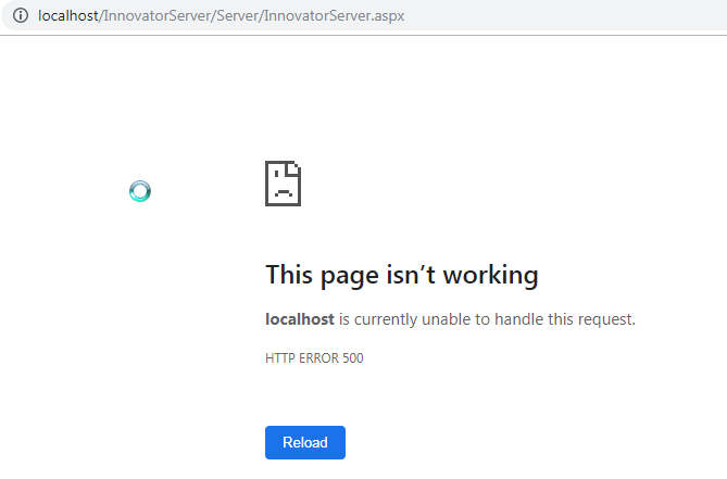

.However when accessed localhost/.../InnovatorServer.aspx IIS throws the Error -
This page isn’t working
localhost is currently unable to handle this request.
HTTP ERROR 500
Any help is highly appreciated. Thank you

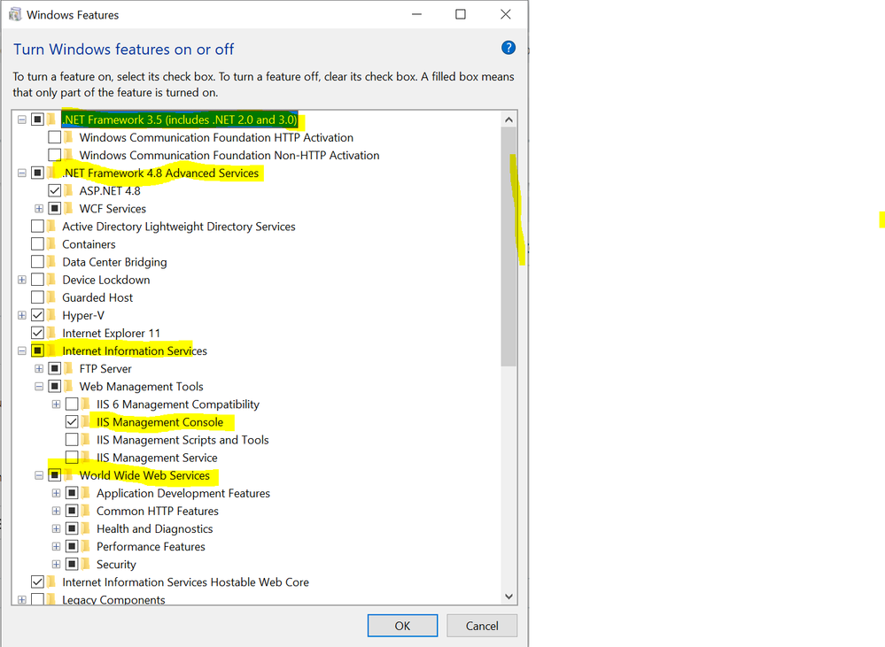

    4. Check .NET Framework 3.5 and 4.8, Internet Information Services is enabled in Turn Windows Features On or Off

      Hello Gopikrishnan,
      Thank you for your inputs.
      I checked with all the points you mentioned and everything is in place.
