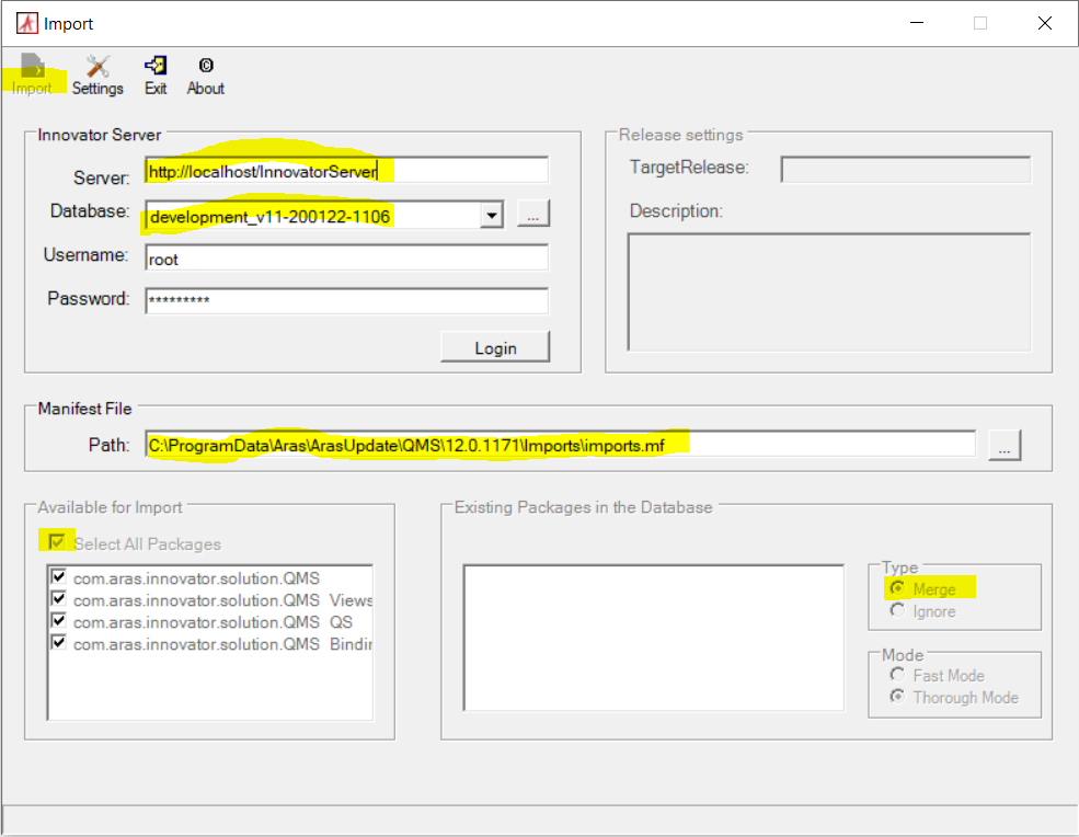

  • Hi
    Can you confirm the type option selected in your import tool. Try merge option if you have used ignore
    Thank You
    Gopikrishnan R

        Hi
        Try manually importing the module.
        Open ARAS Update tool
        Navigate to required Package to be installed (In this case, ARAS Quality Management System)
        Select version and click download instead of Install
        Navigate to downloaded folder (mostly C:\ProgramData\Aras\ArasUpdate\QMS\12.0.1171\PackageImportExportUtilities\Import)
        Run import.exe
        Fill the details as below (select correct import.mf file path)
        Click Import
        Let me know if you are still facing the issue.
        Thank You
