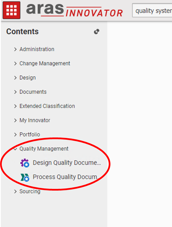

I'm trying to assess the suitability of using Aras for Quality Management in my organization and am unable to install that module. I've installed successfully Innovator 12 and the sample database; h...
Hi Gopikrishnan, thank you for your reply. I don't see the option you've screenshotted in the update tool for Innovator 12. May I ask where/how you brought up this menu?
Thank you so much for your detailed reply! I tried those steps and get two dialog boxes at the end of the process. These seem to be same error(s) as copied in-line above. But perhaps they're a red herring?
I say that because, upon further review, from comparing the very useful image you provided against the existing packages listed for the Sample Database, it seems like it may be fully installed -- or at least fully loaded from the sample database -- but not all of the features are visible on the site (and connected to the sample database). Specifically missing are the Quality Systems elements (e.g., CAPA, RCA)...
How do I check that the install is fully complete? If it is fully complete, how do I enable these features?
