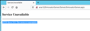

hello everyone, I try to install the aras 12 sp9 and follow the installation guide. but I can't login the system.the webpage show "HTTP Error 503. The service is unavailable." .Anyone give me a hint to solve it? I install on windows server 2012 R2 , sql server 2017 express .4.9KViews0likes3CommentsHTTP Error 502.5 - Process Failure - OAuth - Server

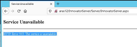

Hi, I have installed Aras innovator SP9 on a windows 7 professional machine (clean machine). I get Service Unavailable HTTP error 503 on a Chrome browser. We have installed in the following order all windows updates IIS .NET 4.5.1 .NET 4.7 Remote server admin tools -> SMTP server tools sql express 2014 with report servicing Aras innovator SP9 default installation with smtp server I can see sql reports http://localhost/Reports I get error 503 with localhost/innovatorserver I get error 503 with http://localhost Then installed IIS with ALL features I have re-installed aras innovator and still same error Any pointers would be helpful best regards14KViews0likes6Comments
