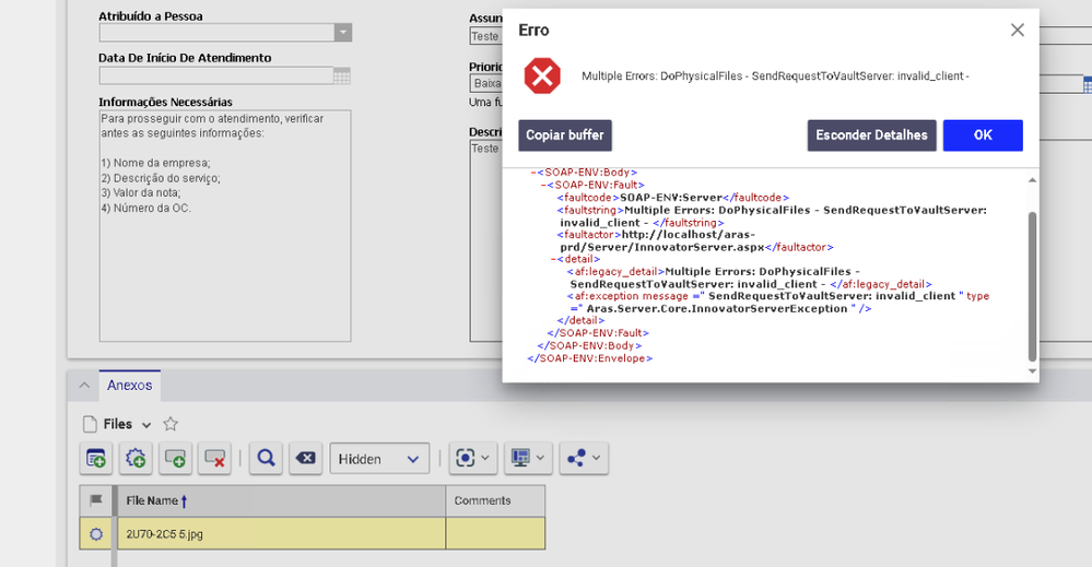

Error when try to upload a file ARAS 12
When I try to upload a file in my Item Type, I receive the error Multiple Errors: DoPhysicalFiles - SendRequestToVaultServer: invalid_client -, it was working normally, but today start to show this issue.
Someone pass by this issue and can help me? Thanks a lot.

    Tks for all, I found the route issue cause, in my case my certificates are out of date, and I fixed it by regenerating new certificates following the topic www.aras.com/.../8428

      Have you changed anything regarding the vault server?
      If you haven´t touched anything, it´s maybe related to your network or even could be a hardware issue. Check if you can access the drive that store your vault data. If your vault drive is still accessible, try to reset IIS and the application pools.
