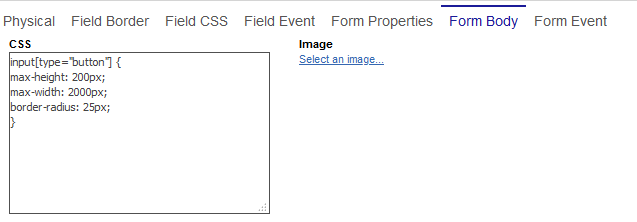

  • Hi Angela,
    I have used the following before, so maybe it will help you, too.
    The background colour can simply be picked under the "Field Type" tab when editing the form:
    Under the "Form Body" tab, you can then insert some CSS for input elements that are buttons:
    Then button then looks like this:
    The "border-radius" makes the corners round, since that was one of your requirements.

  • Hi Angela,

  • Hi cogres,
    beautiful! Thanks for your fast and helpful answer! I can confirm that your solution does exactly what I was looking for.
    I extended your solution so it also change the color of disabled button. By default, disabled buttons have a white background. With the white background disabled buttons look like text labels and people don´t see that there is a button behind.
    This one colors disabled buttons grey: (disabling is done via Method...)
    input[type="button"]{
    max-height: 200px;
    max-width: 2000px;
    border-radius: 25px;
    input[type="button"]:disabled{
    background: #dddddd;
