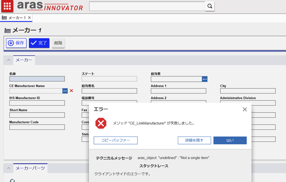

Regarding add maker information, cannot add data of "CE Manufacturer name "
Detected Error:  Method "CE_LinkManufacturer" failed.
technical message aras_object "undefined ": "Not a single item

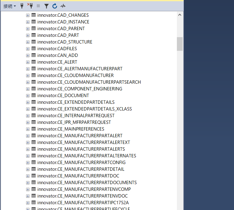

I suspect SQL database table have something issue.
And I cannot find table  for CE_LinkManufacturer.
Though I imported Aras component Engineering "12.0R1", No failure was occurred at that time.
Would you please let me know any suggestion?
Sincerely

    CE_LinkManufacturer is a method and not a table in SQL db. Corresponding database table are CE_CLOUDMANUFACTURER. This is error is so generic. It denotes query return multiple records and method expecting one item. Can you please debug this method CE_LinkManufacturer and check ?

  • Maybe the solution is more simple. In your screenshot you tried to start the sync from a new created part. Do you get the same error message when you try to sync an existing part?
