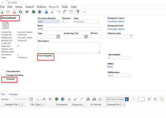

How is the Template field in the consultation Document used?
How is the Template field in the consultation Document used? How does the suggested business process for using the Template Document unfold?
As a comparison, in Windchill, the administrator first creates a document template. When users create a document, they select the document template, and the system instantiates the template data onto the document.
  • It´s mainly used in combination with the Office Connector. It´s described in the Aras Office Connector user guide.
