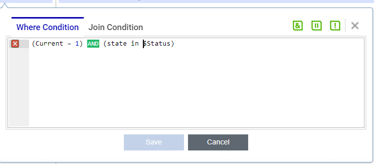

How to use "In" Operator in TGV query builder

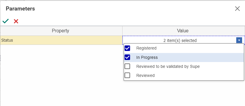

In TGV multi value list datatype is present & we need to filter data based on comma separated selection value. but In operator is not present in where conditions. If we select 1 record it is working  fine but if we select multiple record in dropdown it is not working.

  • Any progress in this topic? we are facing the same issue where we want to use a multiselect in TGV and to use that to filter down the query with the selection.
    Works with 1 value but not several values and can´t find how the get a equivalent function as "SQL IN" within the query definition.
