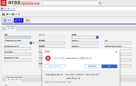

Maybe the solution is more simple. In your screenshot you tried to start the sync from a new created part. Do you get the same error message when you try to sync an existing part?
Hi AngelaIp,
Hi Gopikrishnan,
I tried the case which your advice.
1.If I try to make a new parts, disable to add the data without choosing the manufacturer of pull down menu.
2. I found some warning in method CE_LinkManufacturer source.
I'll upload source code of CE_LinkManufacturer next reply
- M_kaneda6 years agoCreator I
I found warning mark Line 77,88 and 123.
looks these line grammar is incorrect.. but I'm not professional of Java script.
I'm checking them now.

Hi!
Below is result Debug Link Manufacturer
Checking syntax...
ERROR: 45AFF9E39A6A41E58F80DFA14402C476.
Line number 2, Error Number: CS1012, Too many characters in character literal

Line number 112, Error Number: CS1010, Newline in constant
Line number 112, Error Number: CS1012, Too many characters in character literal
Line number 112, Error Number: CS1003, Syntax error, ',' expected
Line number 113, Error Number: CS1012, Too many characters in character literal
Line number 113, Error Number: CS1026, ) expected
Line number 121, Error Number: CS1001, Identifier expected
Line number 123, Error Number: CS1525, Invalid expression term '='
Line number 123, Error Number: CS1012, Too many characters in character literal
Line number 125, Error Number: CS1022, Type or namespace definition, or end-of-file expected
Line number 126, Error Number: CS1022, Type or namespace definition, or end-of-file expected
Line number 162, Error Number: CS1022, Type or namespace definition, or end-of-file expected- M_kaneda6 years agoCreator I
When I executed this method, error is detected as below.
Message is indicated This method type(Javascrip) is not supported.
<SOAP-ENV:Envelope xmlns:SOAP-ENV="">schemas.xmlsoap.org/.../"><SOAP-ENV:Body><SOAP-ENV:Fault xmlns:af="">www.aras.com/.../faultcode><faultstring><![CDATA[ CE_LinkManufacturer に設定しているメソッドタイプ (JavaScript) は現在サポートされていません。]]></faultstring><detail><af:legacy_detail><![CDATA[ CE_LinkManufacturer に設定しているメソッドタイプ (JavaScript) は現在サポートされていません。]]></af:legacy_detail></detail></SOAP-ENV:Fault></SOAP-ENV:Body></SOAP-ENV:Envelope>
