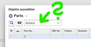

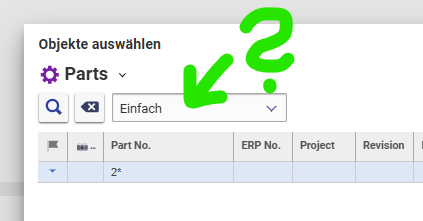

Hi community, I use following code to open a classic Part search dialog. [embed:dc8ab71f-3b98-42d9-b0f6-e21e02a0f8e2:e11e18e7-06f2-4dd3-8697-899cd4f649c4:type=javascript&text=const%20param%20%3D%20%7B%0A%20%20%20%20aras%3A%20aras%2C%20%0A%20%20%20%20type%3A%20%27SearchDialog%27%2C%0A%20%20%20%20dialogWidth%3A%201200%2C%0A%09dialogHeight%3A%20500%2C%0A%20%20%20%20itemtypeName%3A%20%27Part%27%2C%20%20%0A%20%20%20%20defaultSearchMode%3A%20%22AML%22%2C%20%20%2F%2F%20%3F%3F%3F%3F%3F%3F%0A%7D%3B%0A%0Aconst%20topWnd%20%3D%20aras.getMostTopWindowWithAras%28%29%3B%0AtopWnd.ArasModules.MaximazableDialog.show%28%27iframe%27%2C%20param%29.promise.then%28callback%29%3B] Is it possible to pre-select the used search mode? Typically the "Simple" (Einfach) search mode is preselected. I have an additional custom search mode that is similar to Simple, but allows users to search for all generations of a Part. In my use case user shall be able to search and select previous Part versions. So it would be convenient if my custom search mode would be selected automatically when the search dialog is opened. I guess this is currently not possible. But maybe somebody has an idea? Thanks! Angela397Views0likes5CommentsAras search grid edit OOTB issue

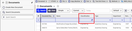

We need to limit the search results of "Document" item for certain identity. The default value of "Classification" should be prefilled to "General" and should be unchangeable by the user. I was thinking if I can get the current identity of the user and then call a function that would prefill the "Classification" to "General" and make it uneditable. I have a code for finding the identity of the user. I need to know how to target the "Classification" field of "Document" item type in the search grid view thanks!165Views0likes2CommentsOpening Aras Part Search on a new Aras Tab through an HTML page

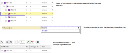

Hello, I'm looking through the community forum for some information regarding filtering/searching on PE_BomStructure tree grid view and query definition. I've got a multi-level BOM that I'd like users to be able to filter by Part Number ( string or item). I followed the Query Element Builders Guide and the blog post "Filter a Tree Grid View with Parameters"; however it only works with the parameters at the top level. Is there any way to effectively filter the 2nd level rows and return the expandable level 1 rows where the item is found? I added a visualization in the attachment.130Views0likes3CommentsPass a Property to a Search Grid
