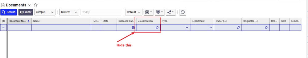

Need server method to hide property of an Item for specific identity
As the tilte says. We want the "Classification" property of ItemType "Document" to be hidden for a user if they are part of a specific identity.
I also want the value of "Classification" to set as "General" for these users when they search of Documents. I have achieved this. However, now we do not want the users of this identity to be able to see the "Classification" column in the search grid. How do I accomplish this.
I apply the code below to "onBeforeGet".
Mentioned below is my method:

  • The only way I can think of is to further modify the classification property in an onAfterGet server method. I have used this for other properties, but it may not work as intended for classification, as it is a core property with some assumptions about the existence of the classification value shown.
