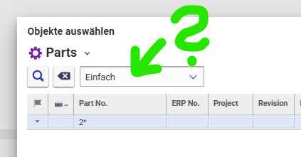

I use following code to open a classic Part search dialog.
[embed:dc8ab71f-3b98-42d9-b0f6-e21e02a0f8e2:e11e18e7-06f2-4dd3-8697-899cd4f649c4:type=javascript&text=const%20param%20%3D%20%7B%0A%20%20%20%20aras%3A%20aras%2C%20%0A%20%20%20%20type%3A%20%27SearchDialog%27%2C%0A%20%20%20%20dialogWidth%3A%201200%2C%0A%09dialogHeight%3A%20500%2C%0A%20%20%20%20itemtypeName%3A%20%27Part%27%2C%20%20%0A%20%20%20%20defaultSearchMode%3A%20%22AML%22%2C%20%20%2F%2F%20%3F%3F%3F%3F%3F%3F%0A%7D%3B%0A%0Aconst%20topWnd%20%3D%20aras.getMostTopWindowWithAras%28%29%3B%0AtopWnd.ArasModules.MaximazableDialog.show%28%27iframe%27%2C%20param%29.promise.then%28callback%29%3B]
Is it possible to pre-select the used search mode?
Typically the "Simple" (Einfach) search mode is preselected. I have an additional custom search mode that is similar to Simple, but allows users to search for all generations of a Part.
In my use case user shall be able to search and select previous Part versions. So it would be convenient if my custom search mode would be selected automatically when the search dialog is opened.
I guess this is currently not possible. But maybe somebody has an idea?
Thanks!

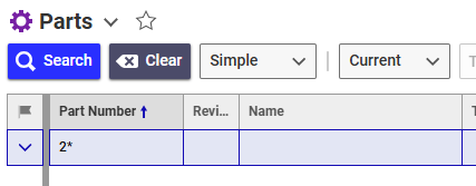

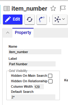

    I usually try to use 'Default Search' option on item_number property
    Which result in search window like below:
    Not sure this helps with your requirement

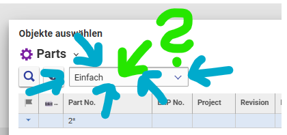

      Thanks for your fast help! I have to admit, you answered my question very accurate and precisely! Unfortunately, my screenshot was a bit misleading. Here's what I'm was actually looking for:
      I don´t think it´s possible to pre-select the search mode in the dropdown. But - good news: I think it was a bad idea from the start and I currently don´t need a solution anymore!

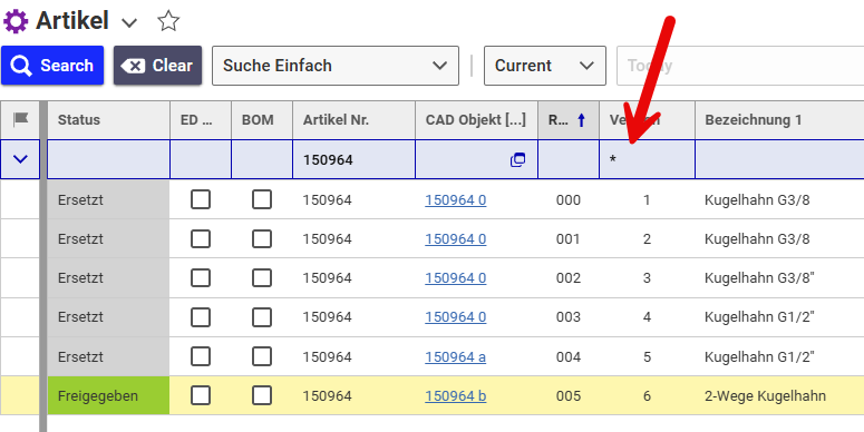

    A easy way to search for all generations is to unhide the generation property in the ItemType.
    Then you are able to search with * in the generation property for all generations.

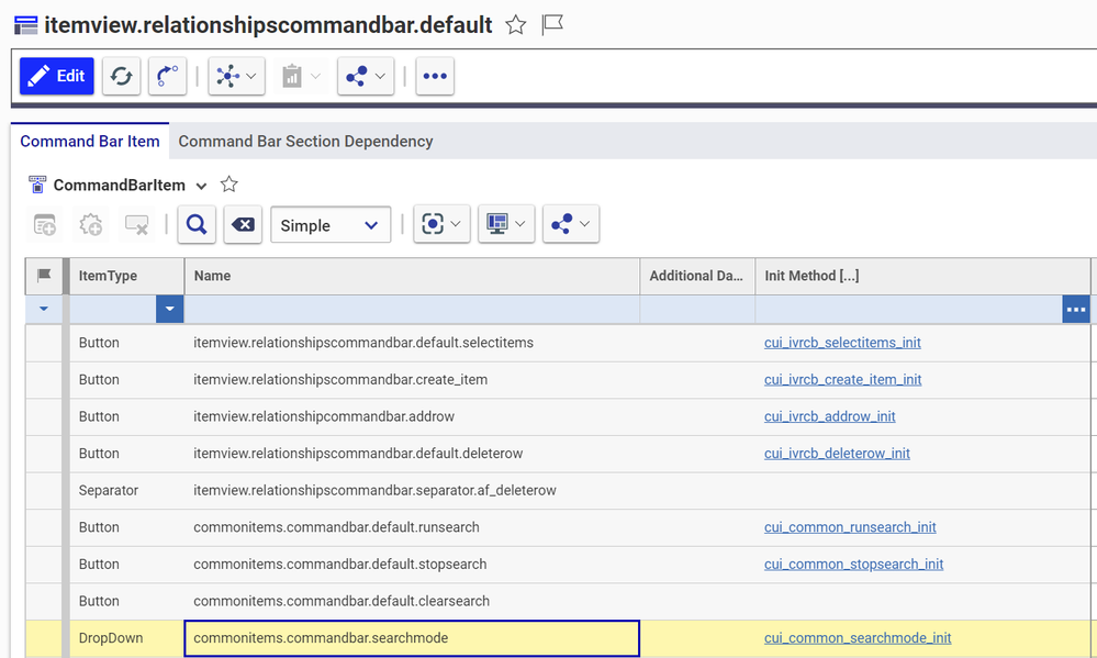

  • I did something similar to enable simple search mode for all relationships grids. I want to belive my example will be usefull to you to find your CUI location and update similar methods:
    I've tried to not change the code tree files and perform changes only in the innovator database.
    The easiest way to achieve such behavior is to use CUI feature and CUI items. More detailed infomration about this feature and examples you can find in the official documentation:
    Aras Innovator XX - Configurable User Interface Administrator Guide.pdf
    You will have possibility to override the behavior for specific items, itemTypes or globally for all entire application
    You will have possibility to override the behavior for specific identities for different level of application described above.
    I will use global presentation to change the behaviour for all items in the innovator

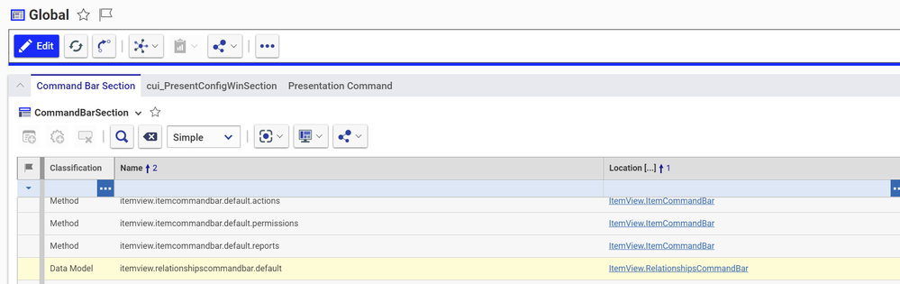

    I know that my control is placed in ItemView.Rel-shipCommandBar section:
    I will change DropDown CUI item for searchMode:
    I will change InitHandler Method to add logic during initialization force search mode for all relship grids:

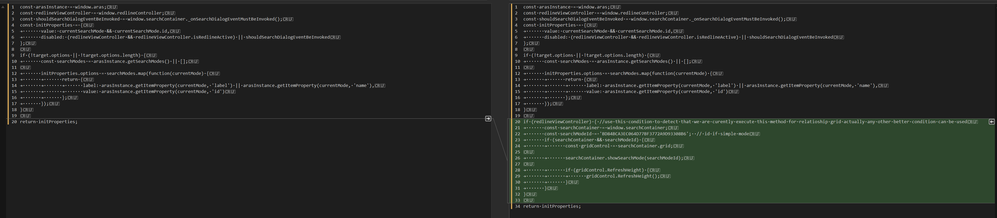

    The comparison view what I've added to init method(cui_common_searchmode_init):
    The method code is below:
