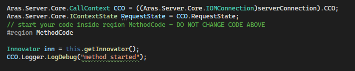

  • in Release14+ in server side method by default CCO object should always be available.
    so it should be enough:
    If it is necessary to add new information to logs from Server method, then it is possible to use CCO.Logger and CCO.LoggerFactory.

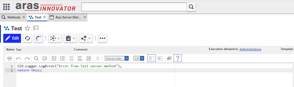

    In simple case we can user CCO.Logger.LogError('message') as you can see in the following picture:
