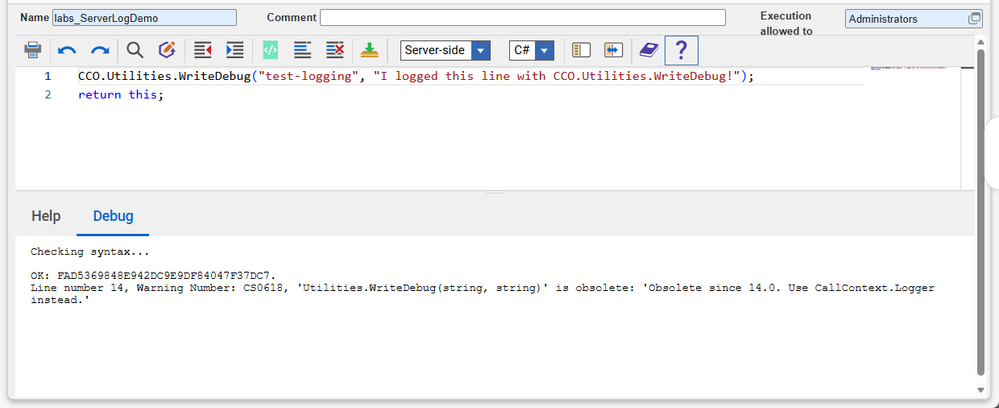

If you've done any debugging in Aras Innovator®, you've probably used CCO.Utilities.WriteDebug() to write messages to a log file. It's been a staple for Aras developers for years - quick, easy, and gets the job done. But if you've recently upgraded to Release 14 or later, you might have noticed something new: a warning message telling you that WriteDebug is obsolete.
Don't worry - your logging code isn't broken (yet). But Aras has introduced a new, more powerful logging system based on Serilog, and it's worth taking the time to understand how it works. In this post, we'll walk through how to configure logging in Aras Innovator 14+, how to write to logs from your server methods, and where those logs can go.

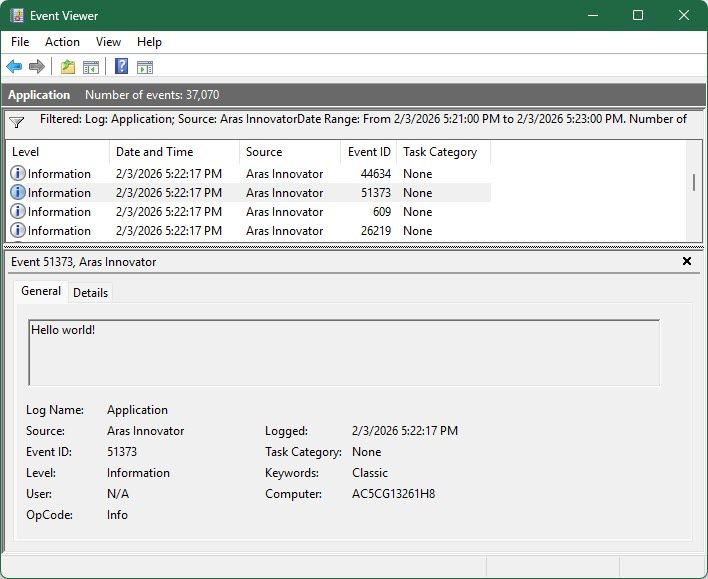

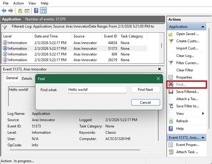

EventLog sink
The EventLog sink writes log entries to the Windows Event Viewer. This is useful if your IT team monitors the Event Viewer for application issues.
And just like the File sink, we have some configuration options:
  • logName - Which log to write to (Application, System, or a custom log)
    • default: Application
  • source - The source name that identifies your application
    • default: Aras Innovator
  • manageEventSource - Whether to automatically create the event source if it doesn't exist
    • default: false
There can be A LOT of events in the Application log even after filtering by source name "Aras Innovator". To find a specific message, we can use the "Find" action in the Windows Event Viewer to locate messages by keyword.
