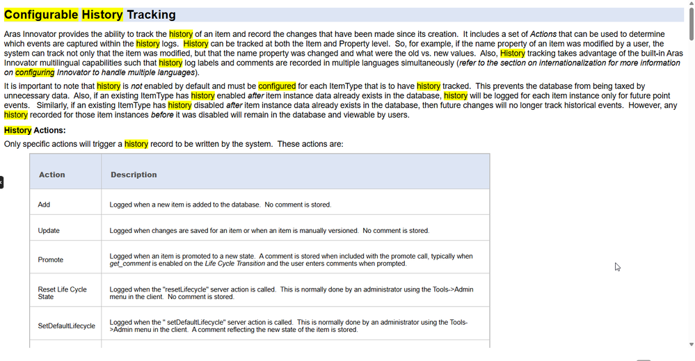

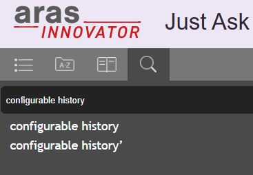

  • Hello
    Go in the Main Menu in the Top right, then click on Help
    Search for "Configurable History" and hit enter key
    You should find all information you are looking for:
    In particular this:
    • kpalevic_lear_com's avatar
      kpalevic_lear_com
      Thank you very much.
      I think this is feasable for our older standard items, which use the normal forms.
      But we are transitioning into ProAppDesigner, which use their separate viewforms, which are not triggered by the "FormView" action available in the History template.
      Do you know, if there is a way to write a custom action for the history?
