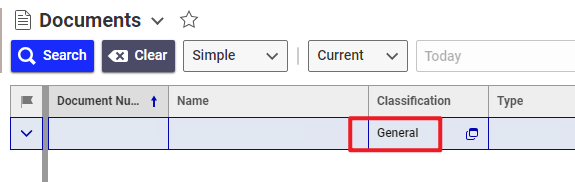

For Documents item type, in the search grid I need the "Classification" to be prefilled to "General" .

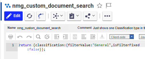

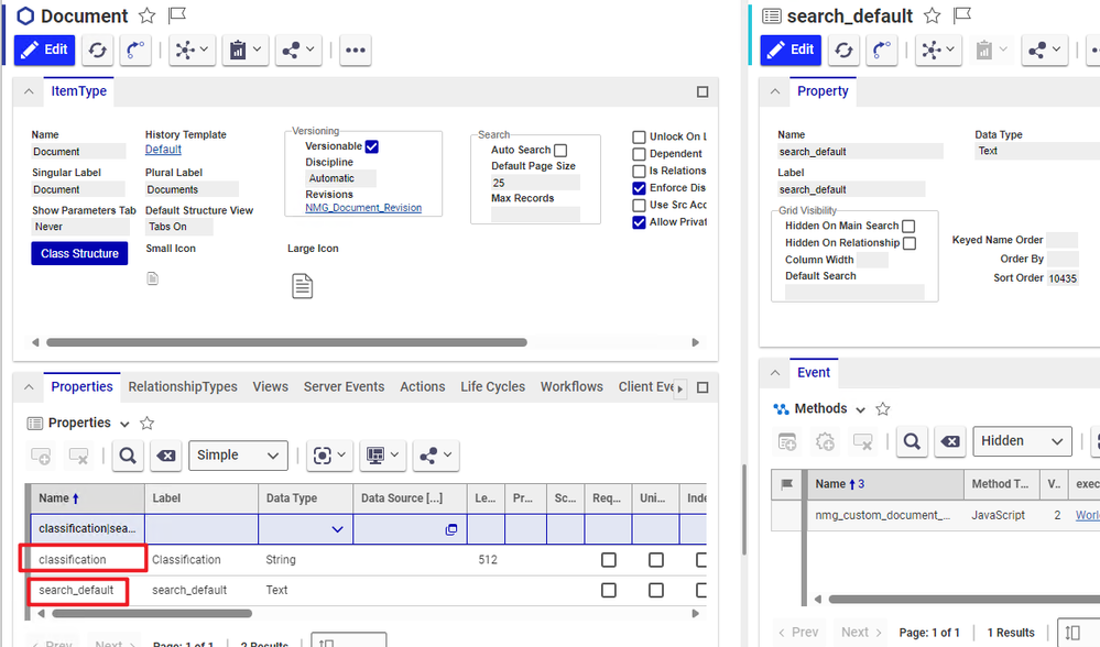

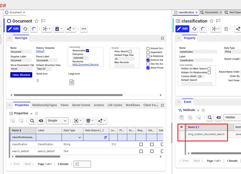

I applied client side method to "classification" and "search_default" properties of Documents but it doesn't work.
"search_default" property did not exist before so I just added it, I don't know if that makes a difference.
method:
return {classification:{filterValue:"General",isFilterFixed:false}};

    using the "Default Search" column for the classification property in your ItemType should work just fine. The filter Methods are typically used for pop-up search dialogs.
    You just need to keep in mind that this feature is a bit of a diva. "Default Search" loves to conflict with user preferences. Have you tried the "Reset preferences" button in the user menu in the top right corner?
