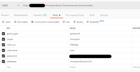

Hello ! I'm using a java application to connect to Aras innovator but i encounter a problem i can't seem to fix when using a remote instance of Aras Innovator. I followed the steps provided here : https://community.aras.com/b/english/posts/token-authentication-using-the-rest-api. When in a local context, absolutely no problem, i can get the token and do whatever i want with it. But once i'm trying to connect to the remote instance (located on a aws server), i'm getting this error : { "error": "invalid_grant", "error_description": "Object reference not set to an instance of an object." } In Postman, my parameters are the followings : They are the same as for the local connection since only the address of the OAuth server is changing. What can i do ?8.3KViews0likes2CommentsVersion 12 SP9 - Cannot access O Auth server 500 error
