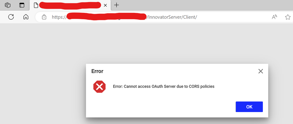

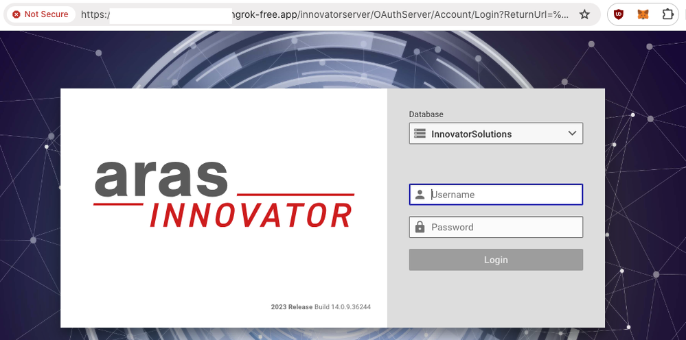

I have installed Aras Innovator 2023 on Windows Server 2022 successfully. I can log in to the Innovator Instance using the localhost URL on the server and the hostname_server URL on the same network machine without any error. I am using the Ngrok Tunneling Client to forward the static domain to the local host to access the innovator Instance outside the network. While doing so, I am receiving an error that states "Error: Cannot access OAuth Server due to CORS policies".

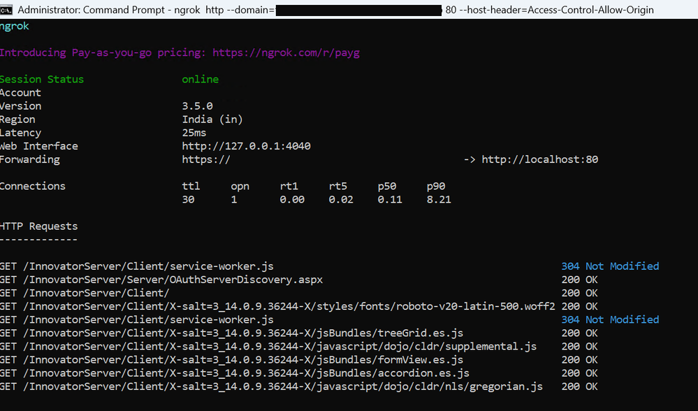

Below is the command used for Ngrok tunneling
cmd: ngrok --domain=xxx.yyy 80 --host-header=Access-Control-Allow-Origin
where xxx.yyy is the static domain name

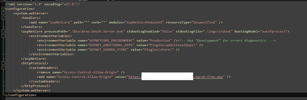

Also, I have modified the below-given line in the <customHeaders> section of ...\Innovator\Server\web.config.
WAS: <add name="Access-Control-Allow-Origin" value="*" />
IS: <add name="Access-Control-Allow-Origin" value="https://xxx.yyy" />

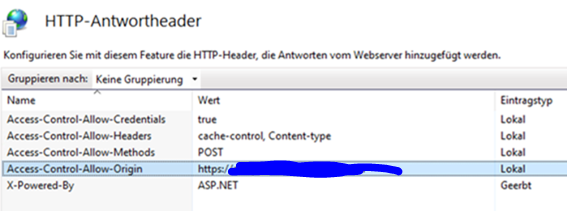

    Just wondering if anyone has the solution to this issue? Adding header to IIS and modifying web.config doesn’t work for me.
    Tried to tunnel using serveo and pagekite, but still receiving the same error.
    Below is my IIS header setting:

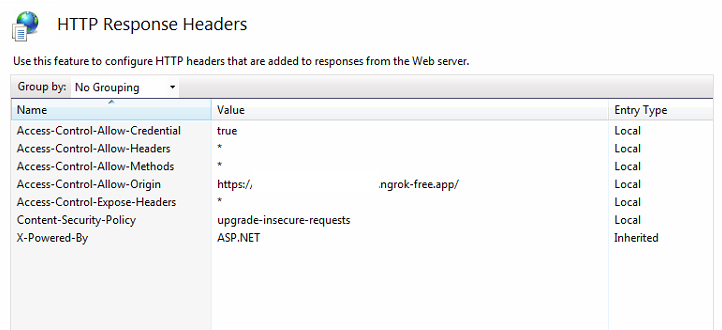

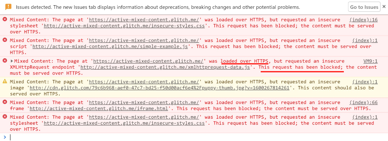

      I managed to fix this CORS issue. It comes down to mixed content being blocked by browser (ie: visiting website from https:// but some content is served using http://). When tunneling with ngrok, the default scheme used is https, thus causing some issue when some part of aras is loaded using http.
      eg of mixed content being blocked.
      Below is my configuration for IIS response header, 0authserver config, and ngrok.
      IIS
      Content-Security-Policy header for HTTP allow for the browser to treat http request as a valid https request. (https://developer.mozilla.org/en-US/docs/Web/HTTP/Headers/Content-Security-Policy/upgrade-insecure-requests)
      Some of the headers are not required but i tend to just leave it like that.

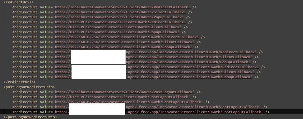

      0authserver web.config
      0authserver 0auth.config

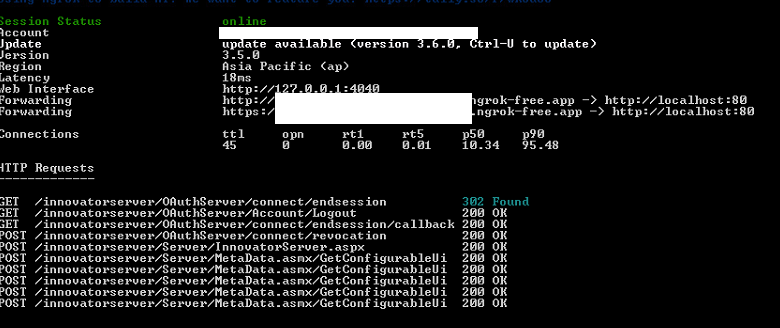

      ngrok
      ngrok tunnel was served using both http & https scheme.

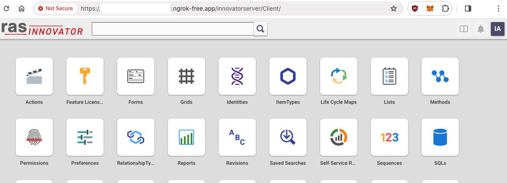

      Accessing Aras through ngrok tunnel

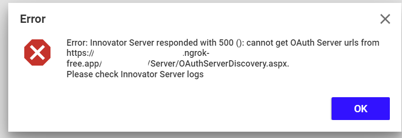

      • nagu_200835's avatar
        nagu_200835
        I have followed the steps. I am getting the below error. I have checked my config files for typos. But no luck. Please suggest.
