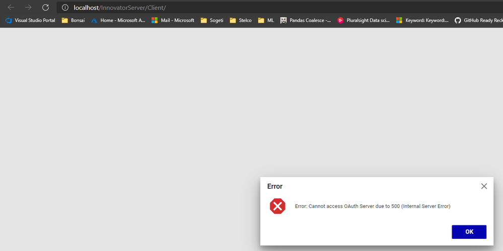

Version 12 SP9 - Cannot access O Auth server 500 error
I installed ARAS 12 SP9 with dependencies of right version installed prior to it.  Installation was successful.
Post installation, I logged into ARAS webclient using edge & chrome and faced the error shown below

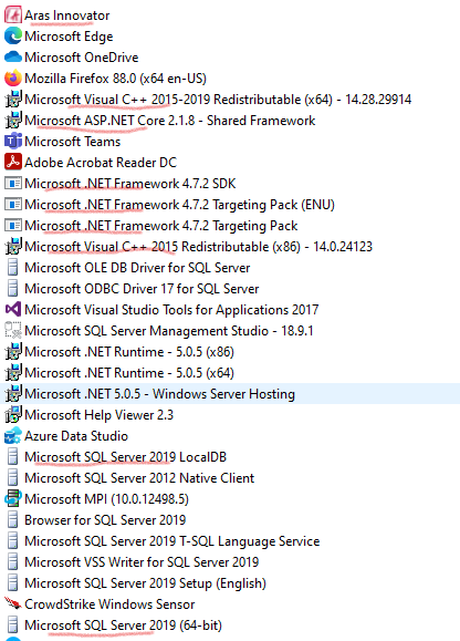

These are the list of dependencies installed

    based on your shown images you made a role model installation. Which unfortunately makes it hard to tell what is wrong.
    OAuthServer 500 error is caused by a missing 2.1.8 Core Runtime. You have installed this one, but have your really installed the "Hosting bundle"? In my case non of the other versions worked.
    See the difference at minute 9:40 in this video: https://www.youtube.com/watch?v=A5QEtOO86ik
    Maybe also the .NET 5.0.5 Windows Server Hosting has some influence. But I am not sure.

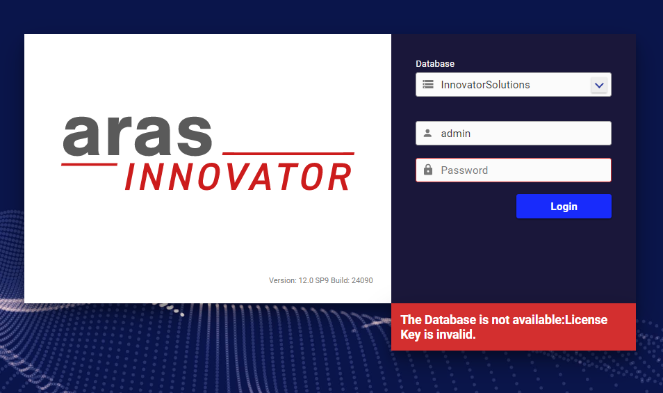

       I’m currently not able to login.  Displays the following error
       I restored the database and also ran following commands.  After restarting SQL server and IIS, still see the same error.
      -- Query 1 (should succeed)
      -- use $(dbname);
      sp_change_users_login 'Update_One','innovator_regular','innovator_regular'
      sp_change_users_login 'Update_One','innovator','innovator'
      -- Query 2 (should fail)
      -- use $(dbname);
      sp_grantdbaccess 'innovator','innovator'
      -- Query 3 (should succeed)
      -- use $(dbname);
      sp_addrolemember 'db_owner','innovator'
        Hi Subramaniank,
        "license key is invalid" is a typical hint that there is something wrong with the license key in the InnovatorServerConfig.xml.
        I address a similar issue in minute 14:10 of my video. In my case the license key was "missing", while it is "invalid" in your case. So I assume you have a license key, but there is something wrong with it.
        Did you pass the correct MAC address to Aras to get the correct license key for the instance you are currently using? You cannot reuse license keys that you may have requested for other servers or previous Innovator versions. Each instance needs a new one.
        Let me know if this one was the reason. It would be a good addition for the video.
