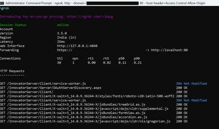

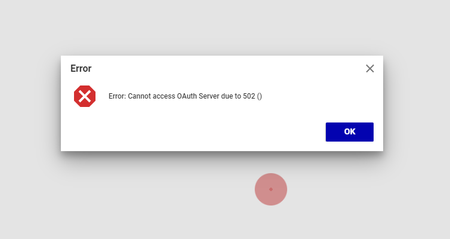

Hello Team, I have installed Aras Innovator 2023 on Windows Server 2022 successfully. I can log in to the Innovator Instance using the localhost URL on the server and the hostname_server URL on the same network machine without any error. I am using the Ngrok Tunneling Client to forward the static domain to the local host to access the innovator Instance outside the network. While doing so, I am receiving an error that states "Error: Cannot access OAuth Server due to CORS policies". Below is the command used for Ngrok tunneling cmd: ngrok --domain=xxx.yyy 80 --host-header=Access-Control-Allow-Origin where xxx.yyy is the static domain name Also, I have modified the below-given line in the <customHeaders> section of ...\Innovator\Server\web.config. WAS: <add name="Access-Control-Allow-Origin" value="*" /> IS: <add name="Access-Control-Allow-Origin" value="https://xxx.yyy" /> Finally, I followed the below steps to solve the issue which didn't help though. [Reference: https://github.com/ArasLabs/aras-workflow-approval/issues/1] The following steps will also avoid the CORS error: Open the IIS Manager. Select your Aras Innovator instance from the site list in the Connections pane. In the center pane, select HTTP Response Headers from the IIS section. In the Actions pane on the right, select Add… Add a header with the following values: Name: Access-Control-Allow-Headers Value: database, authpassword, authuser, soapaction, content-type Click Add… again and add another header with the following values: Name: Access-Control-Allow-Origin Value: https domain to whitelist or * Ngrok Log: Client Error: Note: The above approach is for testing purposes only.597Views0likes8CommentsRenewing expired Oauth certificates lead to error 502. What can be the reason?

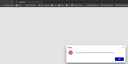

I installed ARAS 12 SP9 with dependencies of right version installed prior to it. Installation was successful. Post installation, I logged into ARAS webclient using edge & chrome and faced the error shown below These are the list of dependencies installed Why does it fail to load login screen?4.8KViews0likes5CommentsHTTP Error 502.5 - Process Failure - OAuth - Server
Hello, After installing ARAS Innovator 12 SP9 community edition, I got the HTTP Error 502.5 as I tried to login onto the new instance. First thing I did was checking the prerequisites for ARAS innovator, but everything was ok. So I started to analyse the underlying problem, and it turned out that the XML file .../OAuthServer/OAuth.config is not a valid XML document. At line 86, you find "1:" right before the "redirectUri" tag. Please remove this two characters and it will start to work. Hope this is helpful until this mistake is fixed. Best regards8.4KViews1like4Comments
