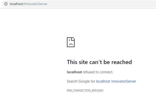

After successfully installing Aras Innovator and MSSQL, I am unable to start website "http://localhost/InnovatorServer". I am getting below error.

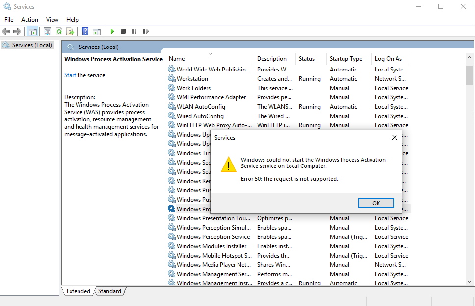

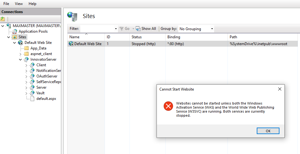

I have checked my IIS status and tried to start the Default Web Site. Got below error!

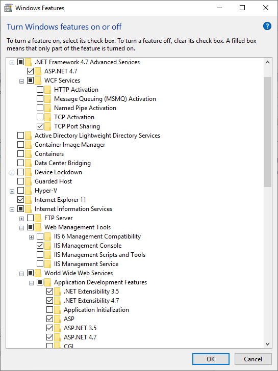

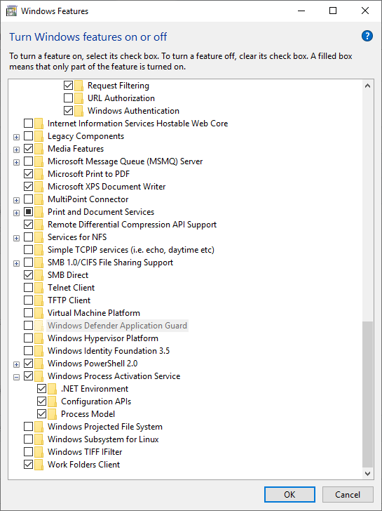

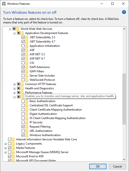

Current Windows Feature settings are as below.

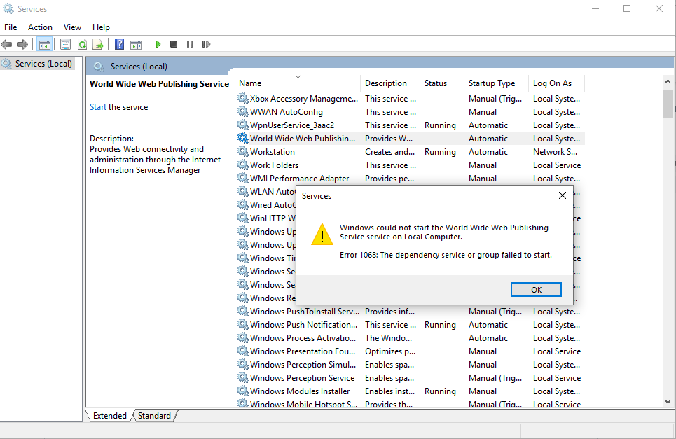

When I tried to restart Windows Activation Services and World Wide Web Publishing Services. I get below error.

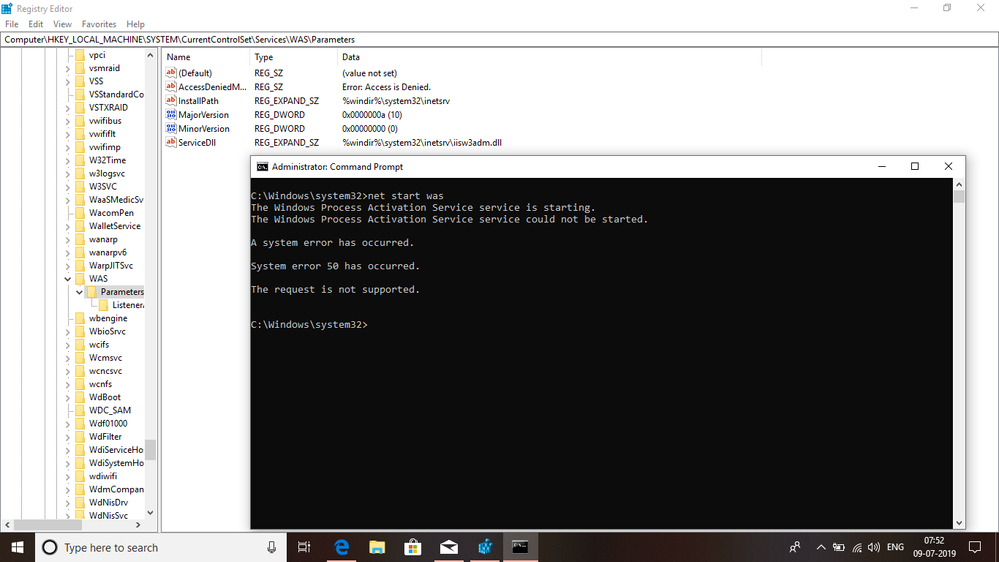

      Hello Chris,
      I have tried the workaround and I still see the same error. Below image for your reference.
      In RegEdit, I don't see "NanoSetup" variable as mentioned in the solution sec. of stackoverflow.
