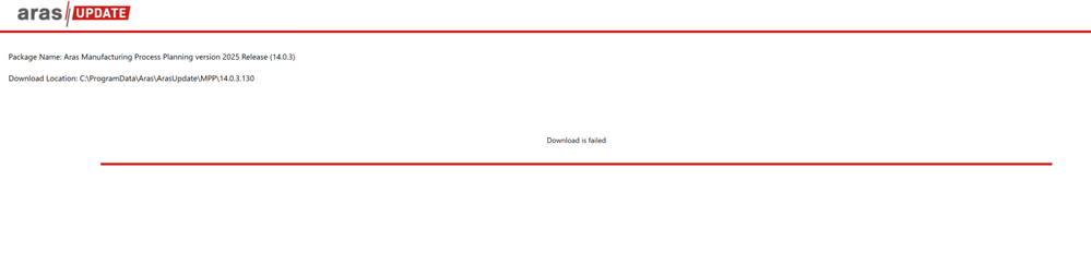

When attempting to download Manufacturing Process Planning version 2025 Release (14.0.3) via Aras Update, the "Download is failed."
Aras Update logs:
[embed:dc8ab71f-3b98-42d9-b0f6-e21e02a0f8e2:a821e795-7faf-4c9d-bb35-be36ae44a7df:type=text&text=2025-09-02%2009%3A54%3A55%2C868%20%5BERROR%5D%20%2811%29%20-%20System.IO.InvalidDataException%3A%20A%20local%20file%20header%20is%20corrupt.%0D%0A%20%20%20at%20System.IO.Compression.ZipArchiveEntry.ThrowIfNotOpenable%28Boolean%20needToUncompress%2C%20Boolean%20needToLoadIntoMemory%29%0D%0A%20%20%20at%20System.IO.Compression.ZipArchiveEntry.OpenInReadMode%28Boolean%20checkOpenable%29%0D%0A%20%20%20at%20System.IO.Compression.ZipFileExtensions.ExtractToFile%28ZipArchiveEntry%20source%2C%20String%20destinationFileName%2C%20Boolean%20overwrite%29%0D%0A%20%20%20at%20System.IO.Compression.ZipFileExtensions.ExtractToDirectory%28ZipArchive%20source%2C%20String%20destinationDirectoryName%29%0D%0A%20%20%20at%20System.IO.Compression.ZipFile.ExtractToDirectory%28String%20sourceArchiveFileName%2C%20String%20destinationDirectoryName%2C%20Encoding%20entryNameEncoding%29%0D%0A%20%20%20at%20Aras.Tools.ArasUpdateCore.Implementations.FileManager.DecompressZip%28String%20packagePath%2C%20String%20zipPath%2C%20String%20extractPath%2C%20Boolean%20isDeleteAfterDecompress%29%0D%0A%20%20%20at%20Aras.Tools.ArasUpdateCore.Implementations.Archiver.DecompressZip%28String%20packagePath%2C%20String%20zipPath%2C%20Boolean%20isDeleteAfterDecompress%29%0D%0A%20%20%20at%20Aras.Tools.ArasUpdateCore.Implementations.Commands.DecompressZipCommand.Execute%28CancellationToken%20cancellationToken%29%0D%0A%20%20%20at%20Aras.Tools.ArasUpdateCore.Implementations.Commands.CompositeCommands.DownloadCommand.Execute%28CancellationToken%20cancellationToken%29]

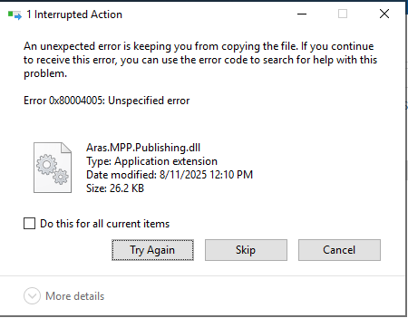

Opened C:\ProgramData\Aras\ArasUpdate\MPP and attempted to manually extract 14.03.130, and extract fails:

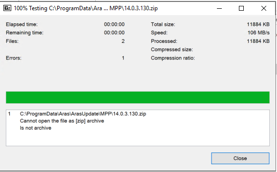

Tested the archive for 14.03.130 with 7-Zip, and it is reported as not an archive:
