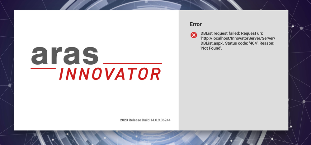

When I install innovator, open localhost/innovatorserver, I can jump to the login page, but it shows that the DBList.aspx file cannot be found. I looked for this file locally and could not find it.When I install innovator, open localhost/innovatorserver, I can jump to the login page, but it shows that the DBList.aspx file cannot be found. I looked for this file locally and could not find it.
had the same error as you and i had the wrong path configured in the OAuthServer.config file under the OAuth configuration.
