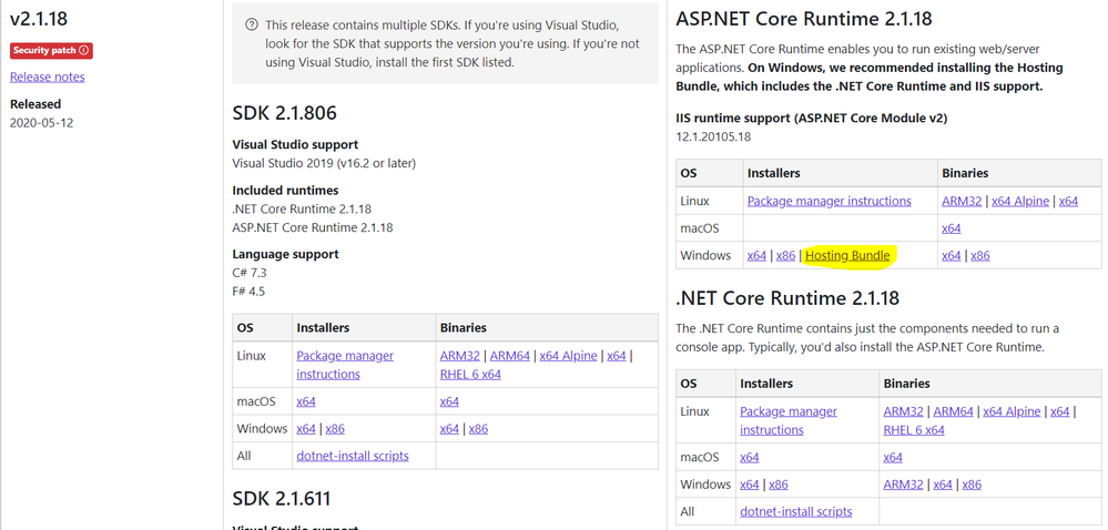

      I'm able resolve this by installing the hosting bundle
      • DarkShadow's avatar
        DarkShadow
        Thanks that worked... So, I assume that Aras really need both 32/64 bits .core installed to work. Maybe the documentation would bit one bit clearer and maybe have hyperlink to the actual needed file from microsoft :). Thanks again!
