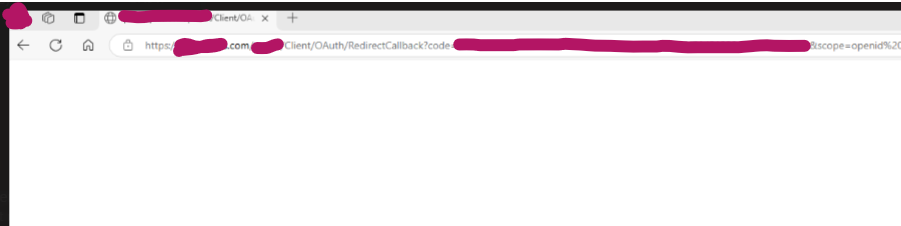

I made a mistake in the description. It´s not the login token that is stored in the link, but redirection related stuff for OAuth.
This is the original screenshot from the end user. Description: "After log-in I get a white screen in both Firefox and Edge."
I think what people do looks something like this:
1. They open the official recommended link 2. They ignore all my "Important Notes" in the invitation to only store the official recommended link (important step!) 3. Login page appears. Browser redirects to the shown URL 4. People bookmark the page. 5. After login they would get the regular link again. But it´s already too late. 6. People can access Innovator with the "wrong link" for a certain amount of time without any problems, but sooner or later they will get the white page.
