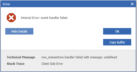

I am new to Aras so i dont really know what am doing. However i have been working on a small project where i require a row event.  when i add the below code to the Relationship type with the event handler OnInsertRow i keep getting an error.  can someone please help me i dont know what am doing wrong.

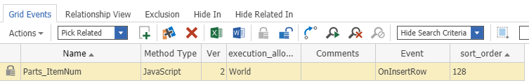

       So i have main item type called Design_Parts  with has a relationship with part_List and that has a  relationship item which is called Design_Part _list . so as far as my understanding goes i have  gone to my DesignPart itemType clicked on Relationship and  clicked on  view relationshipType. In there it has a tab called Grid event and thats where i have maneged to  put this.
      so my code goes something like this but currently it doesnt do anything apart form give me a eror.
