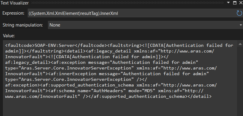

We have upgraded to ARAS 31 from 12. The migration is in progress. While login from application Its working fine. But while login from web API we are getting an error "soap-env:server authentication failed for admin authentication failed for admin"
We have tried to give the password in MD5 hash format for username admin.
But the error not yet solved.
can anyone help us on this?

    Hi Salini,
    The password grant authentication option was deprecated in R14, so you’ll need to update your application to use the OAuth 2.0 login flow.
    Here’s a blog post demonstrating how to get an access token via Postman: https://aras.com/en/blog/authenticating-in-oauth-2-0-with-aras-restful-api
    And here’s a sample console application that shows how to authenticate with an access token via .NET Core: https://github.com/ArasLabs/rest-auth-example
