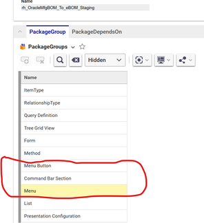

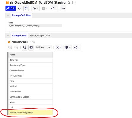

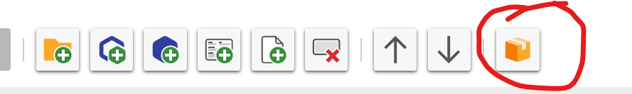

I added the TOC Category (CommandBarMenu) and Itemtype (CommandBarMenuButton) to the Package using the Package Button.
Doing this added the following Package Groups to the package: Menu, Menu Button, Command Bar Section
Next:

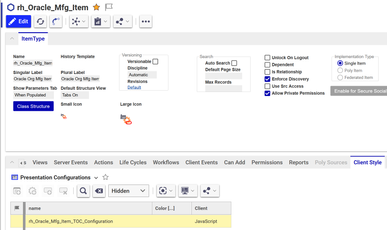

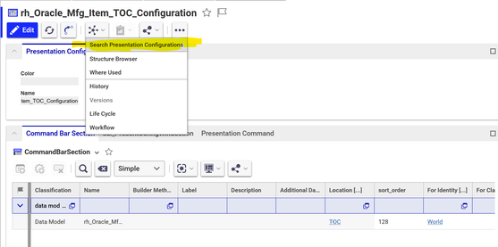

1) I navigated to one of the configured ItemType's, [Client Style] tab
2) Double clicked on on the [Presentation Configuration] in the Grid; "rh_Oracle_Mfg_Item_TOC_Configuration"
3) Clicked [Search Presentation Configurations]

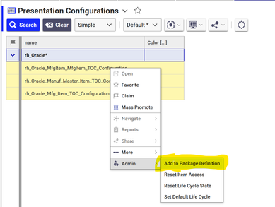

4) Searched for the required [Presentation Configurations],
5) Selected all Required
6) added then to the Package via the right Click [Admin] menu.
Doing this added the following Package Group to the package: Presentation Configuration

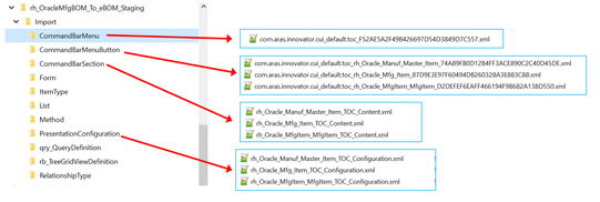

7) I did the Export and all packaged elements were represented in the manifest and import folders

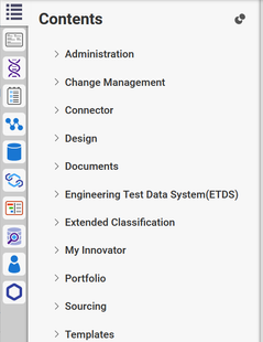

9) In the new Instance I

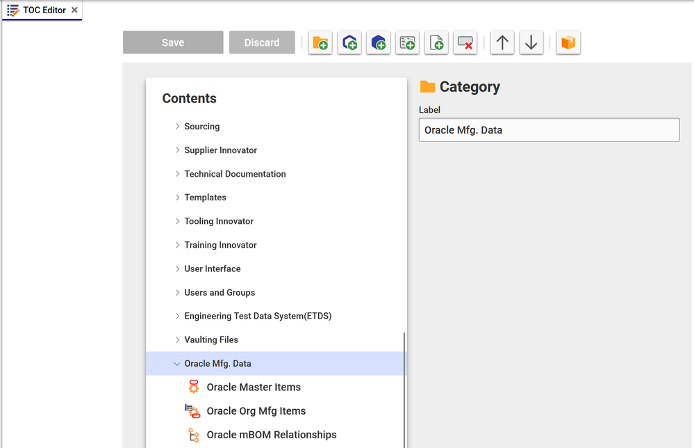

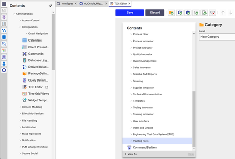

   a) Opened the TOC and nothing. I opened the TOC Editor and nothing

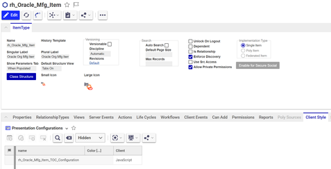

  c) I checked the Itemtypes to see if the [Presentation Configuration] were set on the [Client Style] TAB.
      And they were:

      What I did observe though was that it seems everything was packaged correctly.

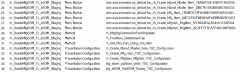

      Here is the SQL Query for a Package check List:
       Get Element included in a package Definition
      Use [Rheem_Prod_2012-01-21]
      Select pkDef.name as "Package Name", pkGrp.name as "Package Group", pkElm.name as "Element Name"
      From innovator.PackageDefinition as pkDef
          Inner join innovator.[PackageGroup] as pkGrp on pkGrp.source_id = pkDef.id
          Inner join innovator.[PackageElement] as pkElm on pkElm.source_id = pkGrp.id
      Where pkDef.name = 'rh_OracleMfgBOM_To_eBOM_Staging'
      Order by  pkDef.name, pkGrp.name Asc, pkElm.name
      What I observed was:
      1) The Folder level was not created
      2) The Itemtypes with icons were assigned to the top level of the TOC
      3) The Itemtypes with not icons were not loaded
      Resolution create the rest by hand.

        I think you are missing the elements that glue everything together. You have Methods and individual buttons and the top presentation config. But where is the CommandBarSection and the CommandBarSectionItem that are in between?
        Take a look at the folder structure of an old Github project of mine:
        https://github.com/AngelaIp/aras-image-uploader-for-tech-docs/tree/master/Import/mppOptions/Import
        Ignore the project itself, it´s outdated and I didn´t know better in the past. But notice the elements that I included into the package.
        I started with CommandBarItem to export the individual buttons/menus. This one is a nice trick, cause this ItemType is a Poly-Itemtype that combines all elements. In addition I exported CommandBarSectionItem cause I extended an existing CommandBarSection. CommandBarSection and Presentation Config are missing in my case, cause they were already there in Innovator OOTB.
        So for CUI go with Item/Section and SectionItem. PresentationConfig only if missing.
