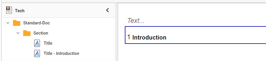

This:
DocumentSchemaElement sectionElement = (DocumentSchemaElement) this.Factory.NewElement("Section") ;
sectionElement.AddChild(this.Factory.NewText("Title","Introduction"));
targetElement.AddChild(sectionElement);
Sort of works.  It creates a section, but it doesn't fill out the Title of the section, it fills it as a child.
Does anyone have any guidance on this?  Thanks in advance!!

      • AngelaIp's avatar
        AngelaIp
        In which XML Schema Element to you use your code?
        You can use an Content Generator for "Section" that add the default title as soon as you add a section.
        E.g. I used this one for a similar "TOC section" to automatically add an "Title" and a "TOC":
        targetElement.AddChild(this.Factory.NewText("Title", "Table Of Contents"));
        targetElement.AddChild(this.Factory.NewElement("TOC"));
        But I really would suggest you to ask Aras support :).
