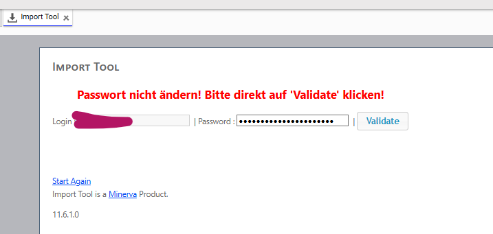

  • Is it this tool?
    The Minerva tools where always some kind of restricted and hard to customize due to the DLLs.

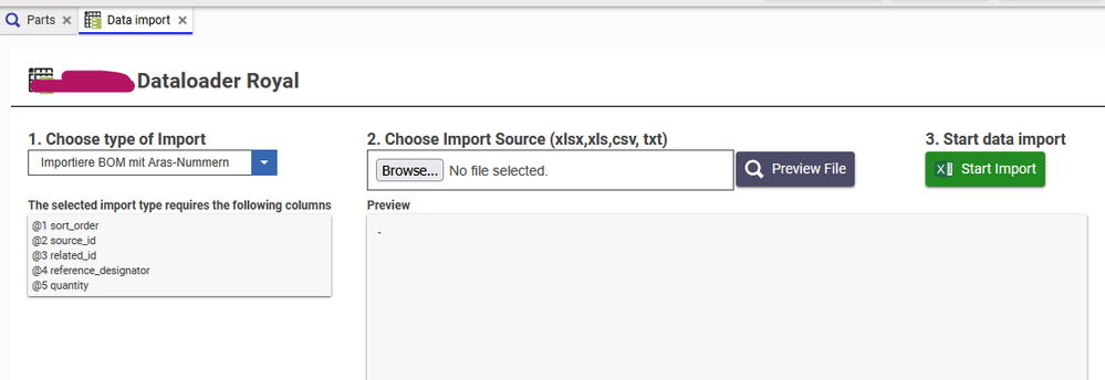

    Regarding data import, since a couple of years we use our own tool:
    It´s  basically a custom version of the original Aras Batch Loader inside Innovator. A second configuration ItemType is used to specify the import type, similar to the original Batch Loader. "Dataloader Royal" can do everything that the AML language and permissions allow you to do: add, edit, delete, merge, import complex structures, and even handle file uploads under certain conditions.
    There are many import tools out there, but I like mine the most. 😇 The design is quite plain, but it’s fully upgradable. Let me know if you want to learn more!
    • I had a suspicion you'd already made a custom tool for this :) I think maybe Minerva customized the original import tool a bit for us (long before my time here), but yeah, I think it's basically the same thing. I'll have a look at Eli's download and compare.
